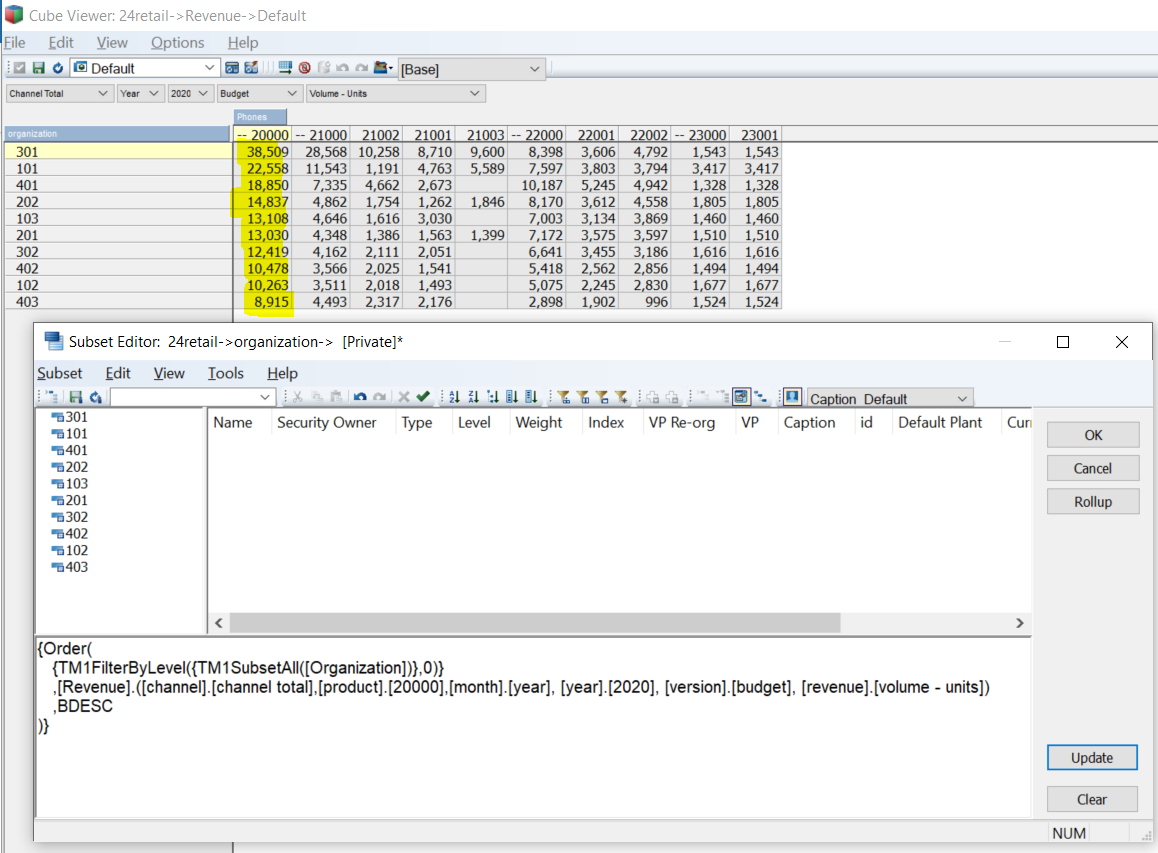

You can still filter and sort using cube values, but you need to use MDX on the dimension you wish to sort
{Order(
{TM1FilterByLevel({TM1SubsetAll([Organization])},0)}
,[Revenue].([channel].[channel total],[product].[20000],[month].[year], [year].[2020], [version].[budget], [revenue].[volume - units])
,BDESC
See attachment for illustration
Similarly you can filter by cube value the below will show only orgnanizations where the volume - units measure is greater than 14000
{Filter(
,[Revenue].([channel].[channel total],[product].[20000],[month].[year], [year].[2020], [version].[budget], [revenue].[volume - units])>14000
Equally if i wanted to show the top 5 organizations I could adapt the first mdx expression slightly, like the below.
{TopCount(
{Order(
,BDESC
,5)}
With this you should be able to replicate your top 10 type reports in PAX without having to resort to VBA.
** Just overlook the fact that my screenshot is on the legacy client it's just what I had readily available, the mdx expressions can also replicated in PAX or PAW using the new subset editor and clicking on MDX at the top right and updating the MDX to the statements given.

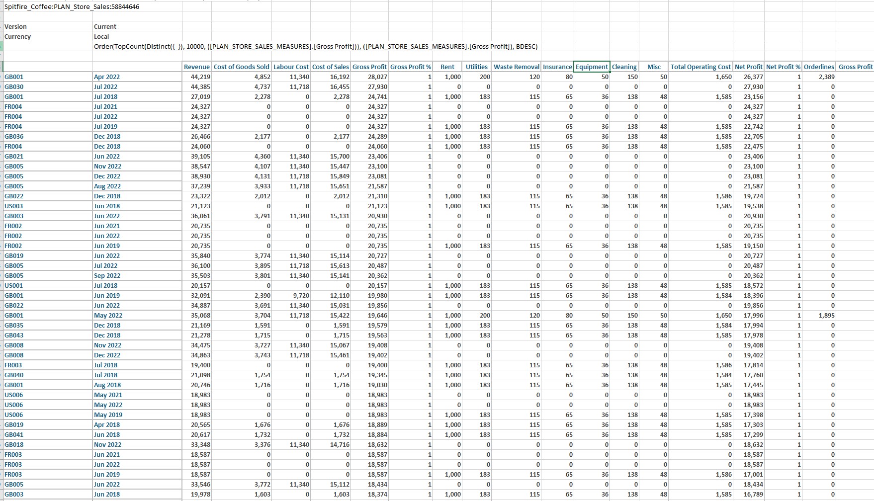

This is exactly what the TM1RptFilter allows you to do, you only specify the columns for which it should do the filtering based/sorting based on and then it applies that automatically to the rows (even when nested).Steve Rowe wrote: ↑Sat Aug 21, 2021 2:39 pm Since generally we need to sort the data we need to be able to sort on the tuples on the rows, AFAIK this isn't possible in a dynamic report and I don't know of a way to have a dynamic MDX view driven report in Excel in Pafe at this point.
A basic example below where it is sorted based on the gross profit column:
