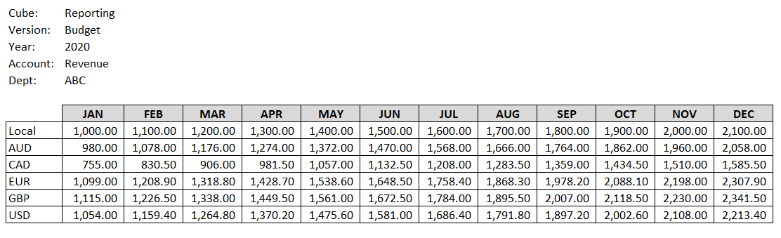

Just looking for some advice on how to structure rules/feeders for fx conversion. I have provided sample screenshots below of the cube structures.
Essentially I am moving from an input cube to a reporting cube which runs 50+ currency conversions (each regional user would like to represent their data in several currencies).
The basics is it converts from local currency to a rate stored in a lookup cube. That part is pretty straight forward. The feeder is not performing great as currently it reads ['local']=>['Total Currency'];
Instead of writing individual feeder statements for each currency type i.e. ['local']=>['USD'], ['local']=>['CAD'] (which I believe achieves the same thing as the above noted feeder) I am looking for some suggestions on how to better achieve this.
Any advice would be appreciated in how this could be achieved. Using a TI to run through this is not ideal as the users will be inputting values on the fly and need to see the conversions happen in real-time.
Thanks in advance!

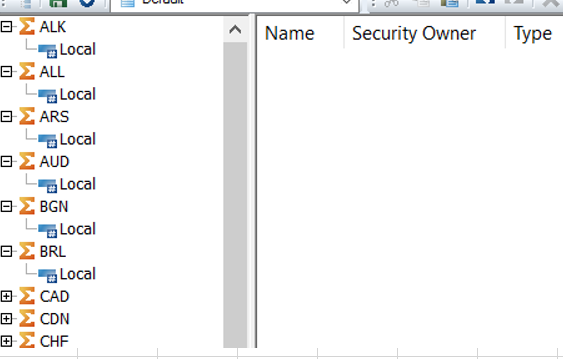

One solution could be to have many currencies as C level elements, with a child as (each time) Local. That would avoid feeders but you also give up the fact that currencies are level 0 elements, capable of capturing input (for certain other areas in the cube, or different cubes, for example). Also, it will be C-level rules instead of N.

Also the thought of adding "local" as a child had occurred to me as well and the rule works well even eliminating the feeder is great but it got a little muddy when consolidating Regions since the consol dept cannot store a local currency type (i.e. Central Europe is made up of various currency types).
