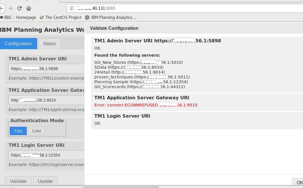

Trying to install Planning Analytics for Proof of Concept purposes....I do not have Windows Server 2016....but have 2 alternative approach that at every stage hits a road block...
PAW on Centos and TM1 System on Host Windows
I am trying to install PAW in a Centos VMWare with the main TM1 application in the host system running Windows 10 Home (ie my laptop..Do not have Windows Pro). No problem with the installation except always....PAW...specifically TM1 Gateway URL (see attached image).
Have done the following
- sudo service docker start
- Ran ./Script/paw.sh - All loaded up-to-date no errors. At times TM1 Gateway has error but is fine after stop and rerun.
- Reviewed ./Config/paw.env parameters...they look ok
- Have sudo installed docker and docker-compose
Could the problem be some PEM file that i needed to copy from the host system to PAW in linux for SSH ? I suspect it probably is caused by some SSH parameters or files to copy.....sick of going around in circle.

A possibility - I got caught out getting Centos 8 from Centos themselves - but it turns out that only Centos 7 is supported. Sure this is documented somewhere :roll:
I have run PAW on Centos 7 within Windows 10 Pro using both VMWare (Player) and (briefly - not a good experience) Hyper-V, connecting to PA (TM1 Server) on the host. Only light use but it all worked.
HTH
Re: PAW installation in Centos Linux or Windows Server 2012
Noticed that it’s only your app gateway that has failed.
Have you done the install using the latest PA software that has web as a separate install?
If so by default both web and app server run on port 9510; which means starting one stops/causes issues with the other. If so easiest thing to do is change the app server port in the IBM configuration tool (and of course allow the new port through the firewall.)

I have the same problem since upgrading to the latest version 2.0.9.3 and PAW SC57 (running on Centos7).
The TM1 server application server URI won’t connect despite changing ports from the default 9510.
I’ve installed the new spreadsheet services add on the same host server as TM1. I can connect via the web browser to it fine. From previous posts I’m guessing this new service is clashing with the old application server ?.
Any advice gratefully welcome !

hardstep wrote: Sun Oct 25, 2020 3:12 pm I’ve installed the new spreadsheet services add on the same host server as TM1. I can connect via the web browser to it fine.
Going back to basics here, can you use a browser to connect to the application server using the ports you have reassigned? e.g. http://myserver:myport/pmpsvc

I changed my TM1 application server gateway URI to : http://server:9910/pmpsvc
When I goto http://server:9910/pmpsvc i get a 404 not found error.
My C:\Program Files\ibm\cognos\tm1_64\webapps\pmpsvc\WEB-INF\configuration\fpmsvc_config.xml shows the new port config (9910).
Meanwhile back in PAW admintool, looking at Page 201 - of the install guide suggests that you can ignore the 404 error :
"This error is the result of an attempt to verify the presence of pmhub. As TM1 Web does not use pmhub,
you can dismiss this error and continue using your applications."
Which is fine but when I try to logon to PAW I get the *really* helpful : unexpected error has occurred
