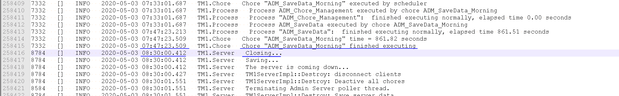

There's a savedata at 7.30 AM and it takes about 30 min usually. It's a daily chore. I will look in the server message log to see when then the save data stopped that morning. It could be that it clashes with the restart. Maybe because we went to summertime end of March... The restart is at 8.30 AM but this sounds like a possibility to check out !
Re: TM1 server registering with Admin server
No, the Savedata was successful and surely before the restart. This was the situation last Sunday morning:
That will not be the problem either.
