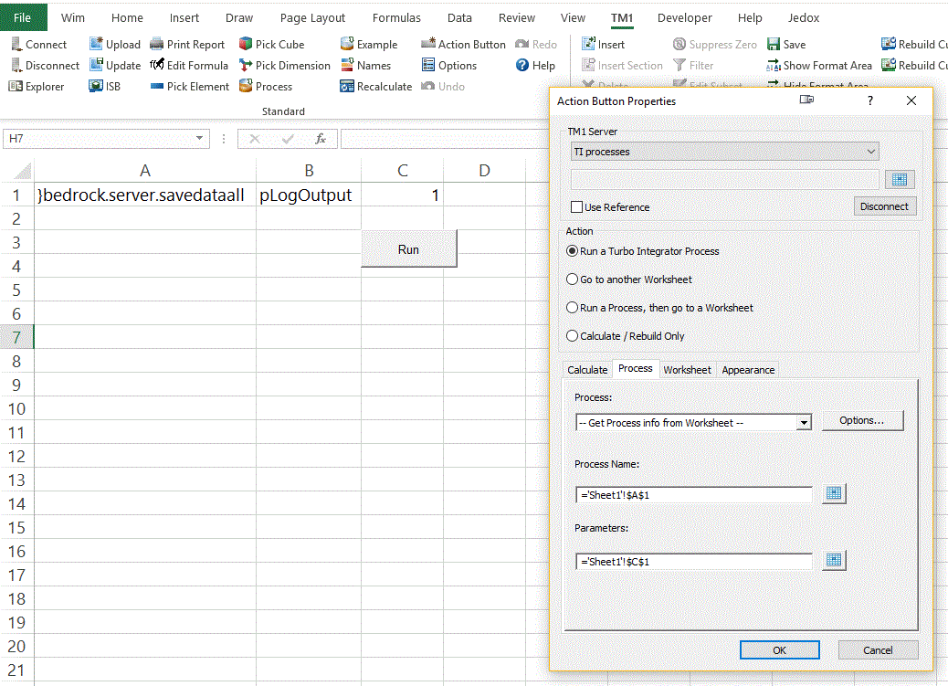

How do I execute a Bedrock TI through an action button ? In other words, how do we see the list of TI starting with a '}' in the Action Button Properties in TM1 Perspectives ?

AFAIK, you need to grab the filename and parameter values from a worksheet cell. See below.

Or you could write a TI with the same parameters as the Bedrock process you want to run, with an ExecuteProcess to the Bedrock TI.

That's what I thought in the beggining but it's tricky for multi-parameter process. I think i'll just clone the process without the '}'
