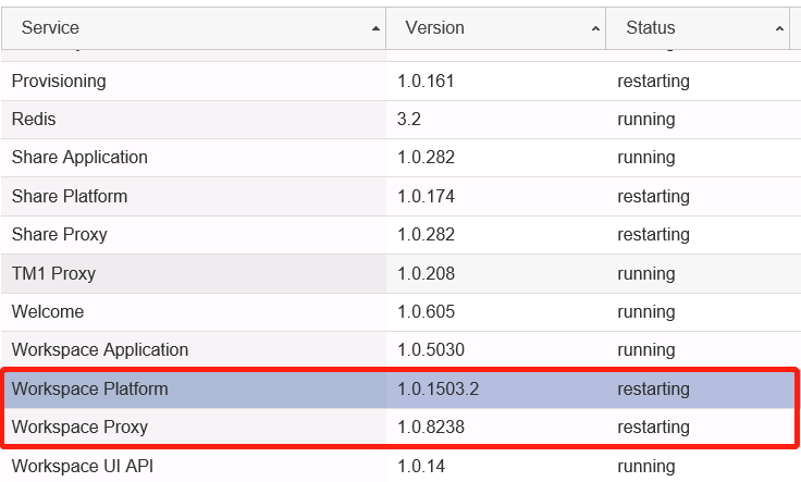

Question:WorkSpace Platform always show restarting after I migrated Docker Container.
Ps: After Docker Migration, I did server-reboot and images upgrade but it doesn't work at all.
Status ScreenShot can be seen at Attachements.
Can anyone help me, Thanks!
PAW always be restarting
- c1c48604573e3b634d1168fc5017cf4.png (21.57 KiB) Viewed 1809 times

Re: PAW always be restarting
Well,I have solved this problme.
Reason:Docker Migration Result Container "pa_gateway" cannot restart.
Solution:1) Backup PAW data file
2) Re-install Docker
3) Modify Docker-Config file to Redirect a new docker-container/images store direction
4) Start Docker
5) restore PAW data file
6) Start PAW
4) Start Docker
6) Start PAW
