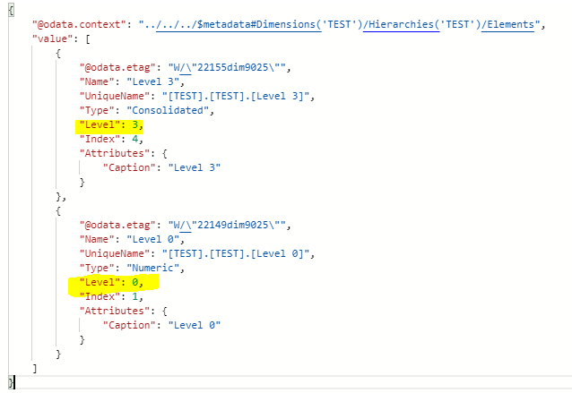

I have a dimension as so:
I have a subset containg two elements from different levels:
If I now use this expression to read the subset via REST:
api/v1/Dimensions('TEST')/Hierarchies('TEST')/Subsets('Default')/Elements
...I get this:
'Level' is the level within the dimension, not the level within the subset. How can I retrieve the element level within the subset? Possible?

Dimix wrote: ↑Tue Mar 31, 2020 10:38 am 'Level' is the level within the dimension, not the level within the subset. How can I retrieve the element level within the subset? Possible?
You can't get the "level" of an element WRT a subset because the concept does not exist. Subsets are merely a collection of specific elements. They don't have a hierarchy, only dimensions do.
