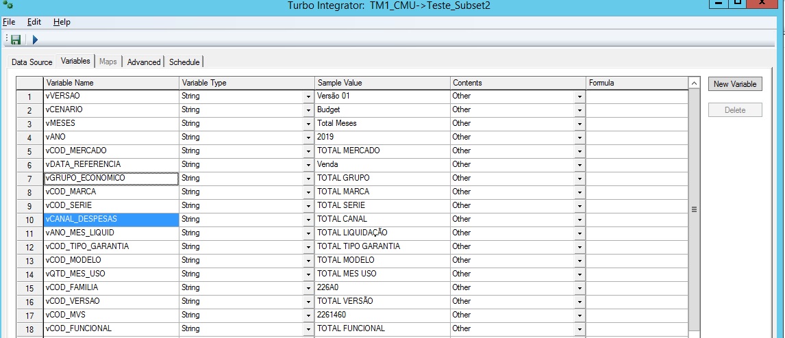

Thank you for your help.
I am using the variables from my source cube.
- var.jpg (165.92 KiB) Viewed 4571 times
- Posts: 2836
Re: Subset having a cube of parameters
Showing us a picture of the Variables tab only proves that it is not blank for the first record in the dataset. Have you confirmed that ALL the records in the dataset have a value in vCANAL_DESPESAS? All it takes is one record to cause the error. While you're at it. Please show us the the entire line from the error log, not just a snippet. That line will tell you the record number where the blank occurs. Are you new to TM1?
