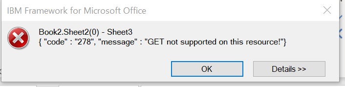

I am attempting a data pull using BCI within PAX. I was originally provided with an exploration that I reformatted in a quick report to better suit my charting needs, however when I went to refresh the data I received the prompt "Code 278, 'Get' not supported on this resource". I then built out my own Exploration with the necessary contexts and am still receiving the same error code. In my own exploration the data is pulling properly, however I cannot make any adjustments once converted into a Quick view, and I cannot format it to my liking within the exploration mode. I have tried saving my exploration to a private view and restarting in a new spreadsheet and closing out all other open excel tabs running PAX, but nothing seems to fix the issue. Has anyone run into a similar problem in the past when using BCI? I also use WConsol and am not getting any errors. (Yes I am sure I am connected to the BCI server when attempting data refreshes.) I have attached the error message below as well, I appreciate any insight.
- BCI Error SS.png (16.69 KiB) Viewed 4014 times

Re: BCI Pull Error "Code 278, Get not supported on this Resource"
