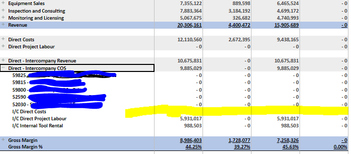

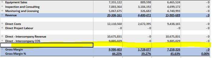

You can see in the attached file "Collapsed" There is a blank white line i have formatted to be all white with white text. Once rows above that are expanded (view "expanded" attachement) that same formatting driven by column "A" doesnt follow the row its tied too and sticks in place in turn blanking out what should be showing in "Direct Costs".

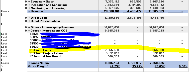

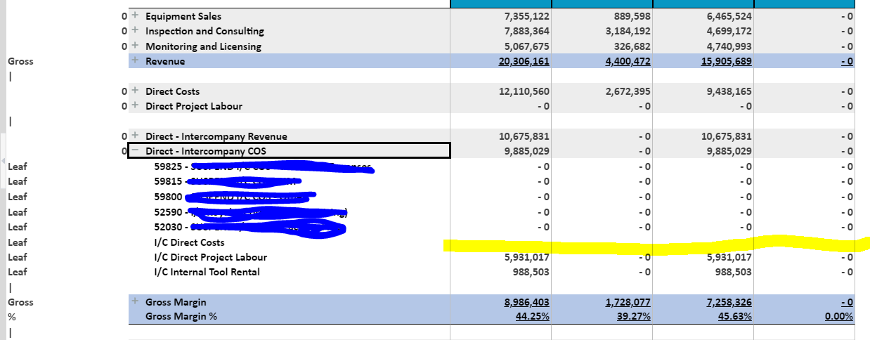

The formula in Column A is built of nested if statements such as IF((Right(B13,1)="%","%",IF(B13="|","Blank")) as an example. The formula is built of look ups with the cell immediately to it right determining the value.
The formatting works fine in Excel and acts as it should. However over the web it begins to break down when multiple rows are expanded. The screen shots below show the look up values that would be in column "A". The stay true to what they should be but the formatting does not. Would the formatting range need to be expanded down to account for the rows expanding or does that formula automatically adjust as you expand the rows? One of the screen shots show expanded rows in tm1web the other is from excel. You can see that over the web it appears to make the text and back ground white of the direct costs row.

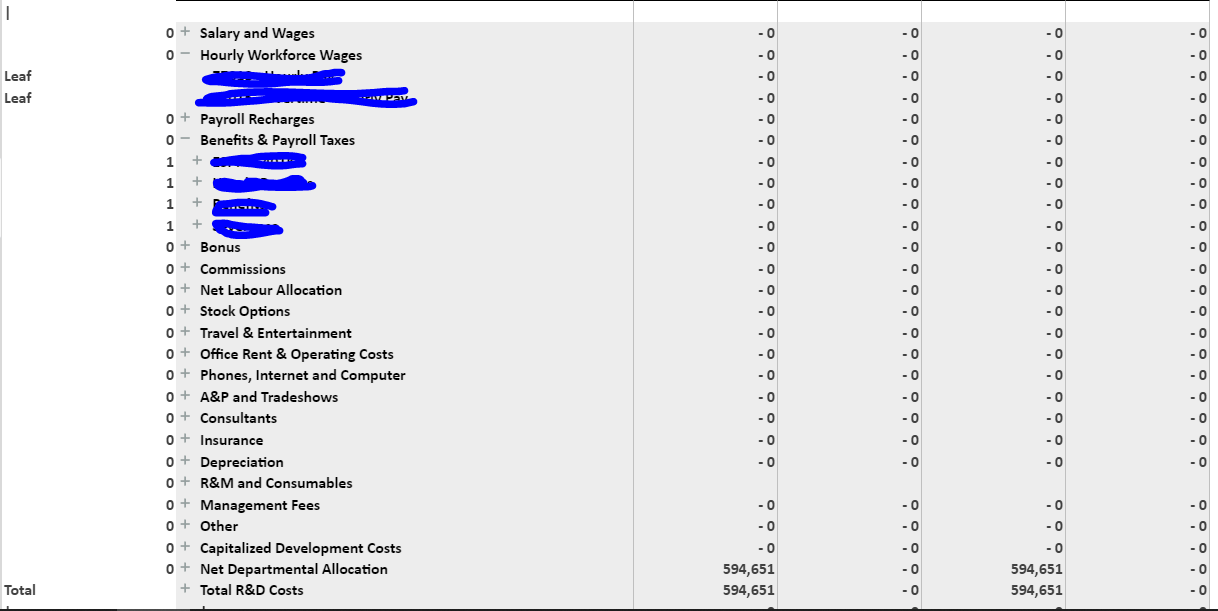

A second issue that's happening is that if multiple rows are expanded, further down the income statement the formatting becomes inconsistent too, for example section totals like "R&D total" which should be a blue color, change to a grey like a cell which does not represent a total. Making the report difficult to read as the "sectioning" identified by colors is lost.

As mentioned above, here are two screen shots of what transpires further down the report as more rows are expanded.
One screen shot shows the proper formatting of what a total should look like (leaf should be white background). The other screen shot shows how the formatting is lost and all rows become grey, loosing the visual stop to each section and organization of the report.
