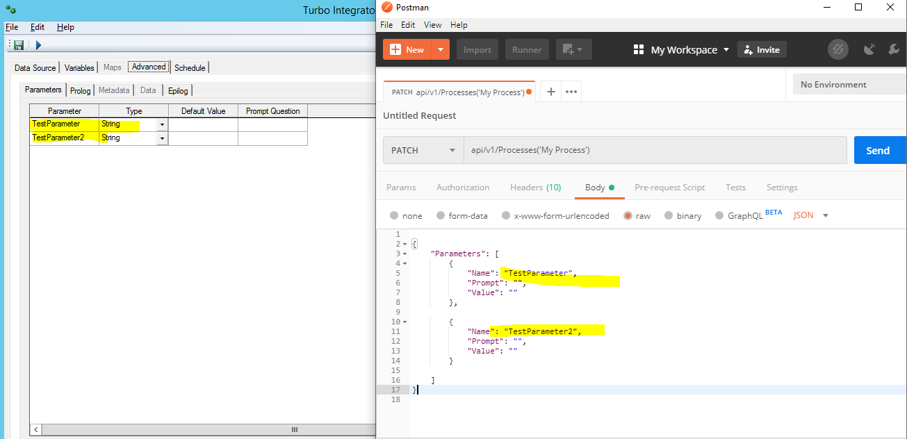

If you are as pedantic about your TI parameters order as I am, you have probably found yourself deleting and recreating parameters many times.
This limitation can be easily solved with PATCHing your TI via Rest API.
Before:

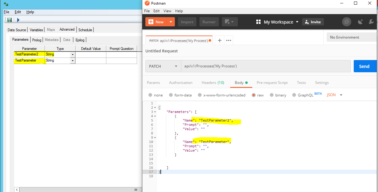

Simply change JSON around, After:
Cheers
