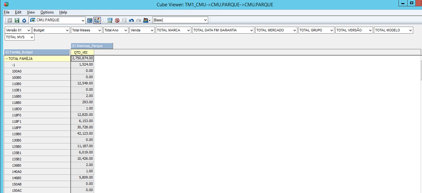

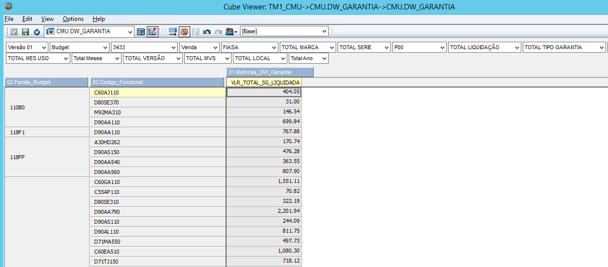

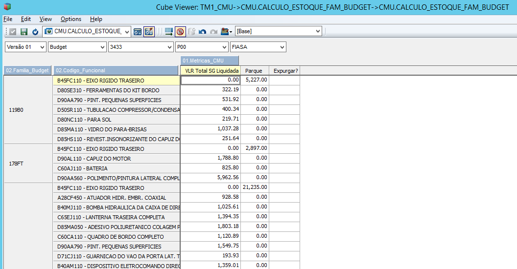

I have two cubes. The first cube has 14 dimensions and I load it through a .txt file. The cube has no rules.
The second cube has 15 dimensions and its origin is my cube 01 which has 14 dimensions.
My problem dimension is the 02.Cod_Functional dimension.
I have a calculation to be performed on another cube that I need to have the park information (number of vehicles) in the functional code granularity. As in my cube 01 (origin) I do not have this information in this granularity, I need to allocate this park by functional code, to then perform my calculation. I agree with you that this makes no sense at all, but it is a business rule. I fought a lot until I could convince myself of that.
I tried to do it as a rule, but the feeder got too big due to the size of dimension 02.Cod_Functional.
Second
1) My source has 113770 records.
2) Yes, I'm ignoring zero and consolidated cells, as prints attached.
Third
1) No. Both cubes have no rules either between them or to another cube. I am doing all cube interactions via process.
2) Cubes have no rules between them or for other cubes.
Attached are some prints of the cube structure and the rule editors.

First

For the sake of illustration, as per the appendix what I basically need is to have the park information in the same VLR Total SG Liquidada structure.
The VLR Total SG Liquidada information I have in the functional code structure, not the parque code.
And I need to load the park as the VLR Total SG Liquidada was loaded, that is, the same functional codes.
VLR Total SG Liquidada comes from another source and is in the functional code structure.

I have two cubes in different granularities:
Cube A
Dimension A
Dimension B
Cube B
Dimension A
And I have a third cube
Cube C
With dimensions:
Dimension A
Dimension B
This third cube has two measures:
VLR Total SG Settled
Park
The measure VLR Total SG Settled originates from cube A.
The measure Park originates from cube B.
What I need is to allocate the Park values from cube B to cube C.
This dimension B is dimension 02.Functional_code that has 6863 items.
The following images illustrate cubes A, B, and C.
Having the two cubes in common the dimension A.
My target cube needs park information to do a simple calculation.
Ideally I would only allocate the park where it has VLR Total SG Liquidated information, but that would be the perfect world.
Doing the proportional calculation is not business friendly because there is a dimension in the model that is common to both cubes called 02.Familia_Budget which is like a cost center, not a cost center but just making an analogy for translate the granularity of the business, and each item of this dimension has a number of vehicles that need to be calculated according to the functional codes, existing in dimension 02. Functional Code. The functional code is a code linked to problems existing in vehicles, as problems arise, a functional code is created, so when allocating the park, it has to respect the budget family, because there will be cases that vehicles in the park are new (releases) and no problems related to the warranty of these vehicles have yet arisen.
Once again I apologize for the English and thank you for the answers.
