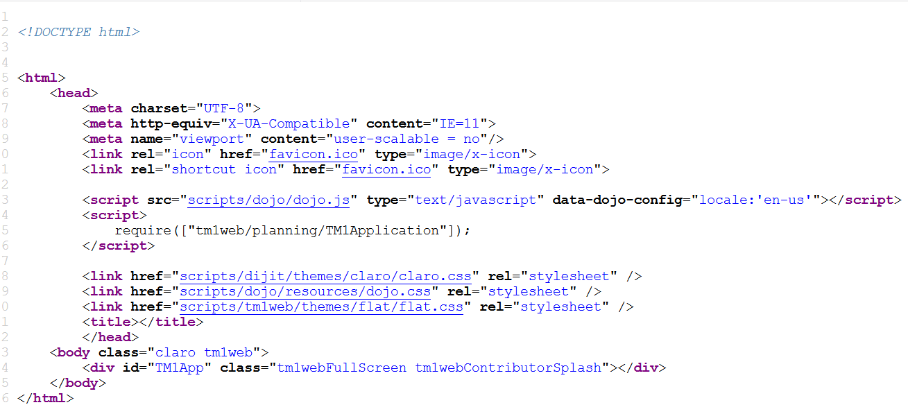

Hi Gurus,
I have an issue with TM1 Contributor Grid opening in Chrome and Firefox but not in IE. We have 3 environments - TEST/DEV/Prod. We do not get this error in DEV and the other 2 env are good. The contributor grid is a blank page and the view source is as attached in the image. Can someone please help? Please let me know if you have any questions.

- Blank Contributor node.png (57.08 KiB) Viewed 2083 times

Re: Contributor Grid opens in Chrome and Firefox but not in IE
Thanks. I found the solution. The reason was that in the file "pmpsvc_config.xml" I did not put "https" and instead, I had "http". The moment I added "s", the issue got resolved.
Paul.
<client id="thinClient" type="html-new" uri="https://aaaaaaaaaaaaaa.com/tm1web/Contributor.jsp">
