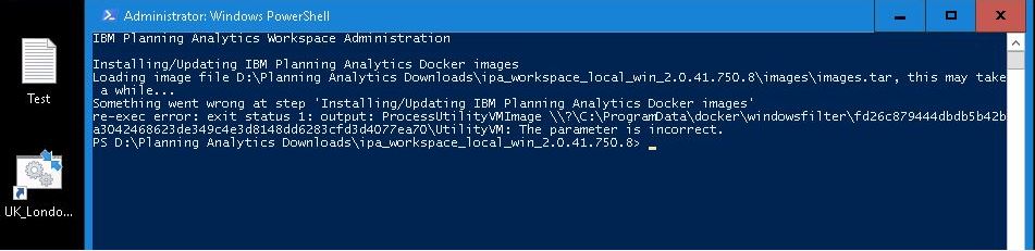

I am trying to install PAL 2.0.6 with PAW in VM Windows server 2016(1607)
When I am trying to extract the PAW image into docker using powershell, I get an error which says Parameter is incorrect
I have 43 GB Free space in C Drive before extracting PAW Image
Please help/guide where I need to look into or modify settings for this to go through

- PAW Docker Error.JPG (53.35 KiB) Viewed 2880 times

You mention space on your C: drive but the screenshot looks like you are installing to D: Remember that the extract will take up a lot a space (close to 20Gb I think when I last installed). It then needs to copy the images to Docker which will duplicate and consume more space. Watch your space carefully during the installation.
Have you watched Installing Planning Analytics Workspace Local on a non-system drive and followed the steps to change the configuration?

This sort of error may appear if you have AV software on the machine that is not compatible with Windows Containers. Any AV software installed on this machine?
