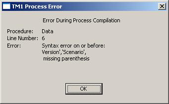

I need some assistance on how to upload a cubeview to MS Access. I'm not familiar with databases.
PROLOG
odbcopen('TM1_Test', 'Admin', 'password');
DATA
odbcoutput('TM1_Test', EXPAND('INSERT INTO TM1_Test ([Version], [Scenario], [Currency], [Month], [Year], [Rate_Assumption_m], [Data[) Values ('Version','Scenario','
Currency','vMonth','vYear','Rate_Assumption_m',Value)'));
EPILOG
odbcclose ('TM1_Test');
I read in some post that with the bracket is applicable for MS Access...with other databases you can just remove the bracket and it will work? Since I plan to test this on SQL Server

- Error on Saving TI
- TI Error.JPG (10.98 KiB) Viewed 13415 times

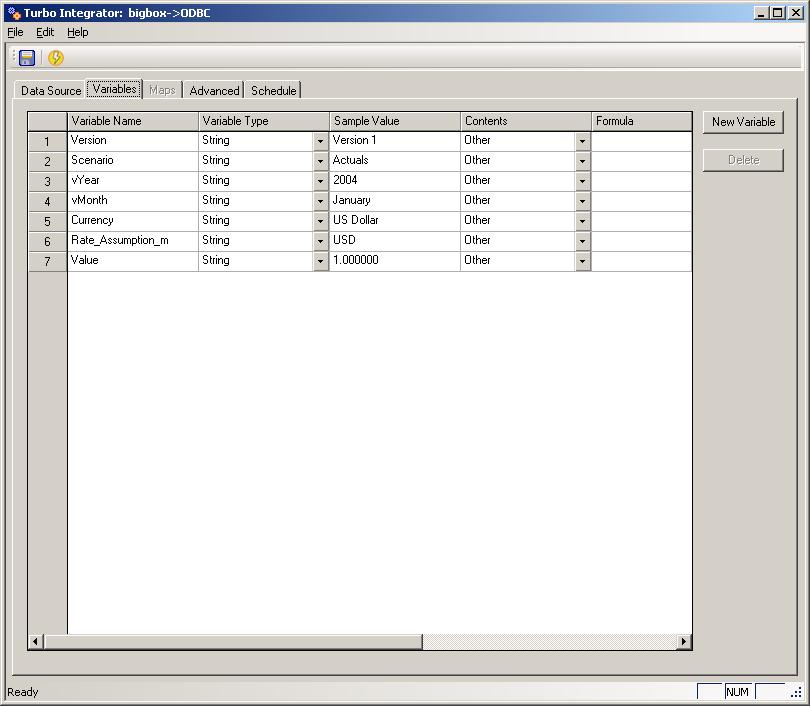

- Screenshot of Variables of Cubeview
- TM1-TI Process_ODBCOutput.JPG (62.21 KiB) Viewed 13416 times

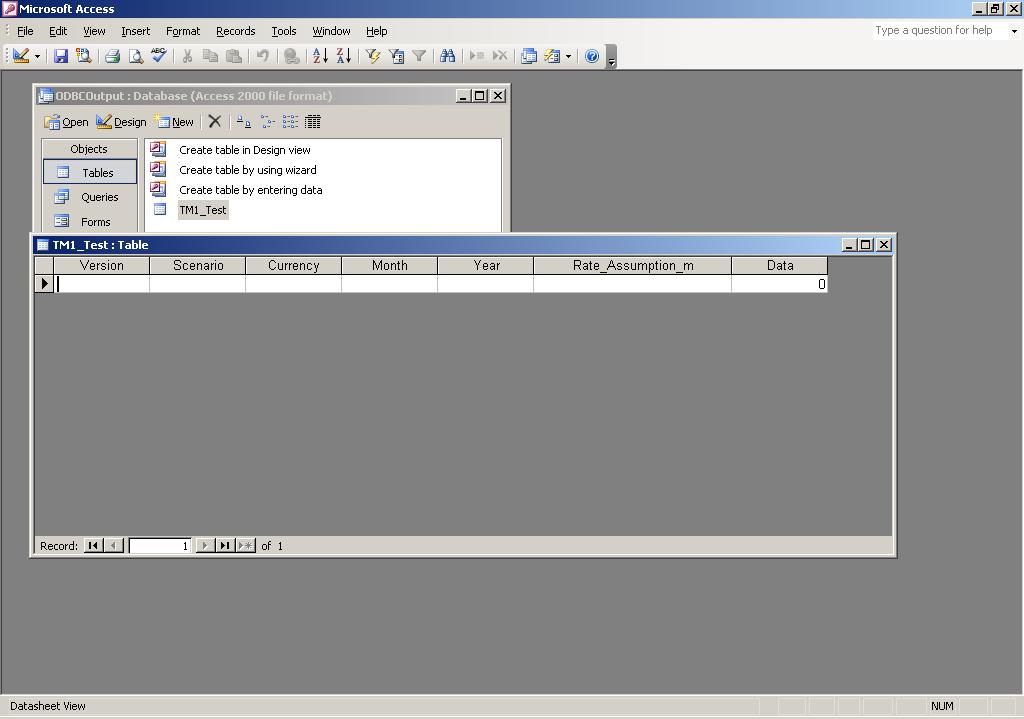

- MS Access Table
- TM1-AccessODBC.JPG (61.71 KiB) Viewed 13415 times

I'm not going to redo this in line with your latest variation in this post, but with regard to the example in http://forums.olapforums.com/viewtopic.php?f=3&t=932...appleglaze28 wrote:I need some assistance on how to upload a cubeview to MS Access. I'm not familiar with databases.
Assume that you have a cube which has the dimensions that you specified in that thread; Version, vMonth, vYear, Measure and Revenue_Center. You create a view from that cube. Your variables are therefore those dimension names, plus one variable called Value.
All of the dimensions are set to a Variable Type of String. "Value" is set to Numeric. All variables have their Contents set to "Other".
You have an Access database which has a table called RC, which has fields with the same name as your variables. All of the dimension name fields are Text fields, and the Value field is a Numeric (Double) field. This database has an ODBC data source name of "Test".
You do NOT have the database open. The database is NOT secured by a password or user level security.
