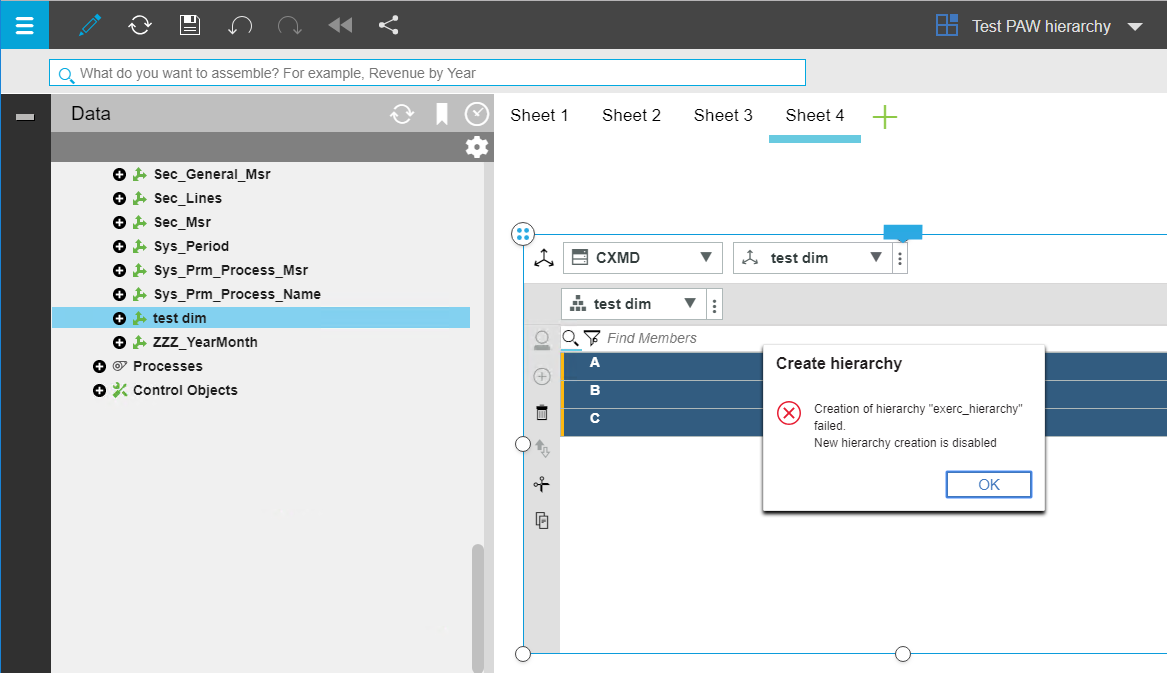

I am trying to use the new hierarchies functionality. However, it seems that this functionality has been disabled:

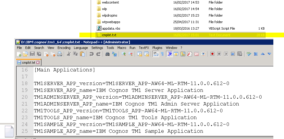

I added the new cfg entry and I restarted TM1:
I am an Admin user in TM1 and PAW. The PAW version is 2.0.29, TM1 is also certainly recent enough:

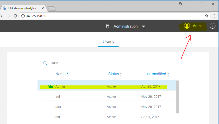

In PAW I use the same user from TM1. It shows as Administrator:
I would assume this user is able to create a hierarchy ?

I logged on with the test user, I tried to create a hierarchy and I get the same message that hierarchy creation is not enabled.
