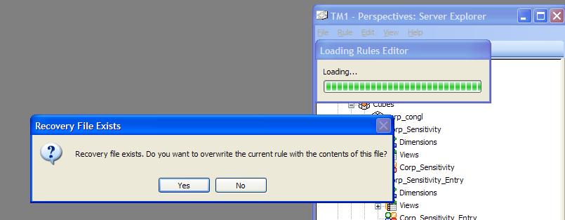

I'm getting the following box appearing every time I open the rule file: "Recovery File Exists. Do you want to overwrite this file..."
http://img413.imageshack.us/my.php?imag ... ilefx9.jpg
I can't get rid of it by saving over the file, or removing and adding the rule file again.

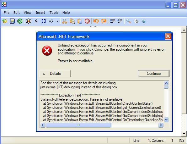

I also can't use the recovery file to recover due to this error:
http://img398.imageshack.us/my.php?imag ... rorte1.jpg
Can anyone advise me on where the Recovery file exists so I can delete it (also just so I know).
Here is the error log from the .NET Framework error:
http://rafb.net/p/aNEqXC69.html
Where are Rule Recovery files kept?

The image works fine for me -
Here are the uploaded images...
- netframework_error.JPG (57.08 KiB) Viewed 6240 times
- recovery_file.JPG (30.06 KiB) Viewed 6241 times

I can't find any reference to recovery files, or spot any in some tests. Which version are you on, and which version(s) of the .Net framework? If it's 9.4, I believe that you need to have the .Net framework version 3 installed to use the Rules editor.

What I'm really interested in is how I can find the recovery file and remove it.
Im using TM1 9.4...
Im using TM1 9.4...

Imageshack is a blocked site at work and it will be for a lot of people, so the upload option is far better
That error looks to be a software rather than TM1 type of issue. If you check the 9.4 documentation (installation guide) it does state that you require .NET 3.0. It might partially work but there are obviously some differences that the rules editor relies on that is causing it to crash.
I'd give up looking for the recovery files and get 3.0 installed, you'll probably find the issue then goes away.NET Framework Requirements

A little relevant thread necromancy here ... this posting seemed to derail into a discussion about imageshack and never answered the original question.
Ran into the same issue using the Enhanced editor with a bad rule when Architect crashed. After a little digging found this link on the IBM site: https://www.ibm.com/support/knowledgece ... 90763.html
It goes into much more detail but basically check out your folder for %appdata%\Applix\TM1\ for the saved temp copies of the problem rule and delete it. Relevant for 9.5.2 through 10.2.2 at least.
Easy peasy.
