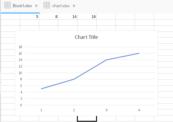

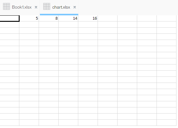

@Declan - would appreciate if you have 5 mins to create a basic chart like the one below-basically typed in some random numbers, highlighted, click on line chart, saved and uploaded then opened in TM1Web: Took the same workbook and hid from row 105 onwards, graph not rendered-only difference between 10.2.2 FP4 and PA is that PA does not show the placeholder when "broken": Thanks in advance
p.s. Book1 was with no rows hidden, chart.xlsx has hidden rows-apologies for poor naming.
In terms of leaving some visible but blank rows - I experiment with 5, 10, 20, 100 - seems to behave the same.

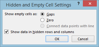

Did You check If the Hidden options are selected on Select Data option on the chart setup?
like the atachment
like the atachment

Hi Rafaewolie, thanks for the suggestion but unfortunately this is one of the things I tried without success. For now I am making sure that I delete "unused" rows and columns then hide the columns only. Seems fine for web purposes as web seems to only work with the used range in the sheet.rafaewolie wrote: ↑Wed Sep 06, 2017 6:23 pm Did You check If the Hidden options are selected on Select Data option on the chart setup?like the atachment

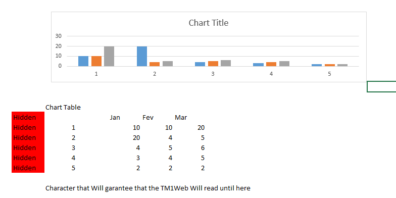

Another thing that I noticed is that, When the last row of some perspectives are hidden, the TM1Web counts 3 or 4 (I'm not sure of the number) rows and then cuts the rest of the hidden lines. I think in that case, the suggestion that Declanr gave You about the white font in white BG Will function, at least to make TM1Web consider the hidden lines. Put a character in a row below the hidden rows.
Another possible solution would be to reduce the row height to 2px. It does not show the content on the screen , but the computer considers this row as unhidden.
Does It make sense?
Does It make sense?

Not before, but After.
Put some character like the picture that I Attached.
The Hidden part is in red, so After that You put some character to paint with White color just to not show It to user.
And Then, TM1Web consider the row that contains "Character that Will garantee that the TM1Web Will read until here" as the last row
got It?
got It?
