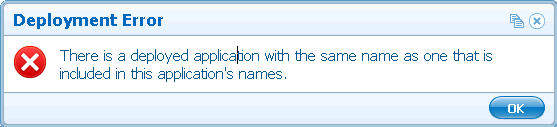

Thanks Elessar, here is the error when I deploy. I do not want to delete and re-deploy as I will lose the rights and other maintenance is required.

Paul-TM1 wrote: ↑Wed Aug 23, 2017 2:34 pm Thanks Elessar, here is the error when I deploy. I do not want to delete and re-deploy as I will lose the rights and other maintenance is required.
Paul.
http://www-01.ibm.com/support/docview.w ... wg21651860
Try this point: "- If Cognos BI is being used, check to see if there is a public folder with the same application name in Cognos Connection and if so, delete it."
Do not run }tp_admin_delete_all: it's the worst, you'll need to recreate all the applications.
