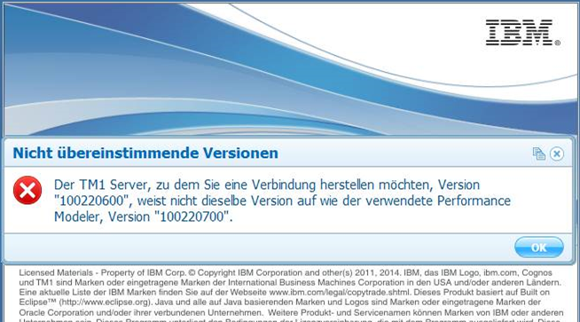

We mistakenly made a migration from IBM Cogos BI from version 10.2.2 FP 6 to FP 7 and also migrated the client from TM1 FP6 to FP7. Can someone tell me how I can make here an uninstall of the TM1 client components. I have the problem, which the PerformanceModeller now says, the version does not fit with my server...
downgrade of Performance Modeller
- Screen Versionen.png (243.56 KiB) Viewed 4265 times

Uninstall the client and then try to open PM from the PMPSVC page, you should be prompted to install again.

try change:
<tm1 install dir>\webapps\pmpsvc\rcp_installs [clients]
<tm1 install dir>\webapps\pmpsvc\rcp_updates [updates config]
try to change to old version in
ModelingMDT.x86_64_app.xml
ModelingMDT_app.xml
I have not tested this solution so unsubscribe if you decide to apply it
