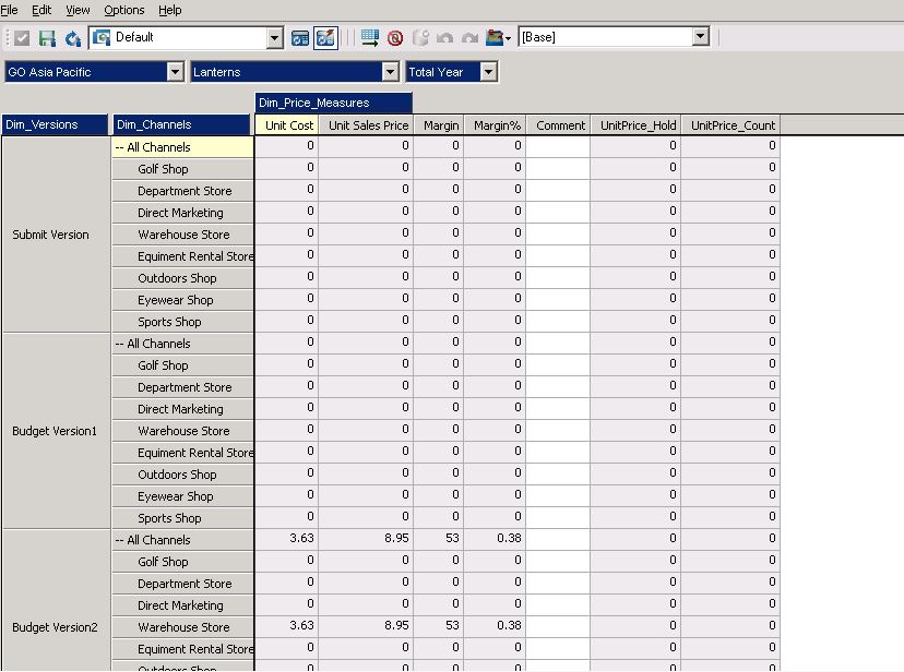

Declan,
I have attached my cube view from TM1 architect, but in contributor view it like for each element from first dimension they are filtering different elements in second dimension. I know by default if we select any element from second element it will be same for all the elements in first dimension. Is there any way to achieve TM1 view similar to contributor view.

Re: Nested dimensions in tm1
I don't have exact view of the contributor, i can like how it looks.
from the attachment which have posted in my previous reply it should look like this, The "Submit version" element from first dimension will have only one element "Golf Shop" from second dimension displayed in the view, similarly the second element "Budget Version1" from first dimension will have all the elements displayed from second dimension. For the last element "Budget Version2" from first dimension will have last element "Sports Shop" from second dimension displayed in the view.

As Tomok mentioned before that is not possible in a cube view in either Architect/Perspectives or Contributor. The only way to achieve it for a cube view is via zero suppression but then you would need at least 1 column to have a value for the rows you want to keep; you can of course use some sort of dummy column called something like "visible intersections" to control that.aravind.cgns wrote:I don't have exact view of the contributor, i can like how it looks.
Arvind
If you use websheets however instead of cubeviews you can get a lot more creative.
