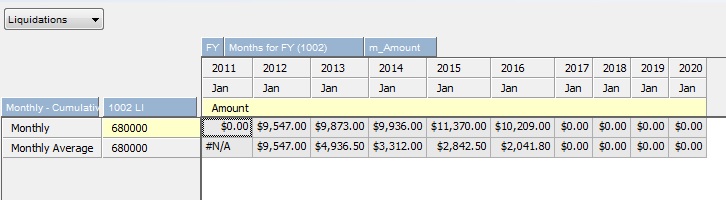

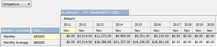

I've attached a snapshot of the cube as well as the rule file.
Again, please don't take my tone to be ungrateful or all-knowing (I am definitely neither), but the logic you provided doesn't coincide (at least to me) with the typical average formula that one would employ.
Layman's terms what was provided:
Average =
((Prior Year Average * Prior Year - 2012) (i.e. 2014 - 2012 = 2)
Prior Year Monthly )
Year Number - 2012 (i.e. 2014 - 2012 = 2)
It's possible that I am misinterpreting what you supplied above, but I've always been familiar with the following average calculation:
Average =
Sum: All months (by month) of prior years
Number of prior years

Right click on one of the calculated cells and select trace calculations to see what is happening.
The code was meant to be amended somewhat and just provide an idea; Mark mentioned in his post 2 of the amendments you should have made - the below is a pointer but will still need some work. If you keep tracking calculations as you make amendments it is much easier to follow.

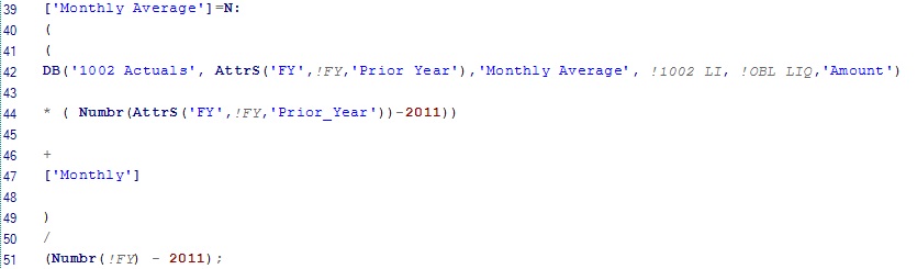

['Monthly Average']=N:
DB ( '1002 Actuals', AttrS ( 'FY', !FY, 'Prior Year' ), 'Monthly Average', !1002 LI, !OBL LIQ, 'Amount' )
( Numbr ( AttrS ( 'FY', !FY, 'Prior_Year' ) ) - 2011 )
+ DB ( '1002 Actuals', AttrS ( 'FY', !FY, 'Prior Year' ), 'Monthly', !1002 LI, !OBL LIQ, 'Amount' )
Numbr ( !FY ) - 2011

I started to re-work the logic with the following:
What I am trying to figure out is how to get the 5 prior years to add and get divided by 5 to create the 5 year rolling average. So far, with the code above, I am getting the current year 'Monthly' + the prior year 'Monthly' only. I do not want the current 'Monthly' to be included - only the 5 prior 'Monthly's

I set up the FY dimension with an attribute to count FYs as well designate a "Prior Year" for each year (i.e. 2011's prior year is 2010).
IF (ATTRN('FY', !FY, 'Count')<=6,
DB('1002 Actuals', ATTRS('FY', !FY, 'Prior Year'),!1002 LI, !OBL LIQ, !Months for FY 1002, 'Monthly', 'Amount')+
DB('1002 Actuals', !FY,!1002 LI, !OBL LIQ, !Months for FY 1002, 'Monthly', 'Amount'),
STET);
- Cube
- Cube.PNG (9.6 KiB) Viewed 11146 times
TM1 10.2.2 - 64-bit | 1-year deep in TM1
Mark RMBC
- Posts: 296
- Version: 10.1.1
- Excel Version: Excel 2010
Re: Average/Rolling Average Question
I am amazed that was the logic you ended up with given the advice, but how about the following (albeit you may need some modification):
** Just an update. Given you have no value for 2011, then the average for 2012 would be 2012 monthly amount or whatever and 2013's average would just be the monthly amount from 2012 and therefore the logic above would start from 2014, i.e. when ATTRN('FY', !FY, 'Count')>3. So you would need to change 2011 to 2012 and you would have to modify each of the ATTRN('FY', !FY, 'Count') parts of the code. Also to make this code dynamic you would need make this['Monthly Average']=N:
If(ATTRN('FY', !FY, 'Count')<=2,
DB('1002 Actuals', ATTRS('FY', !FY, 'Prior Year'),!1002 LI, !OBL LIQ, !Months for FY 1002, 'Monthly', 'Amount'),
IF (ATTRN('FY', !FY, 'Count')>2 & ATTRN('FY', !FY, 'Count')<=6,
(DB('1002 Actuals', ATTRS('FY', !FY, 'Prior Year'),!1002 LI, !OBL LIQ, !Months for FY 1002, 'Monthly Average', 'Amount') *
(Numbr(ATTRS('FY', !FY, 'Prior Year')) - 2011) +
DB('1002 Actuals', ATTRS('FY', !FY, 'Prior Year'),!1002 LI, !OBL LIQ, !Months for FY 1002, 'Monthly', 'Amount')) /
(Numbr(!FY) - 2011),
STET));
refer to the current year rather than the attribute.This way you don't have to change the code year on year& ATTRN('FY', !FY, 'Count')<=6
What you really need is not to have separate dimensions for Year and Month. I know it makes reporting easy but it can make time-based calculations a nightmare. This would be a piece of cake if you only had one time dimension, it could all be done in the dimension hierarchy with no rules. It would be lightning quick and not require any feeders.

Mark - you're a genius. I'm still not 100% keen on exactly what your logic is doing, but I ran it against my "longhand" logic and it works. Thank you for your help - I really appreciate it!
Tom - The model I inherited has a few hundred cubes in it. All are set up with separate FY and Month dimensions. This is one of those "it is what it is" situations.
Thanks again to anyone who put in time and effort on my problem! I'm grateful!
