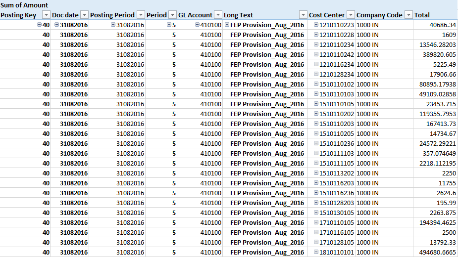

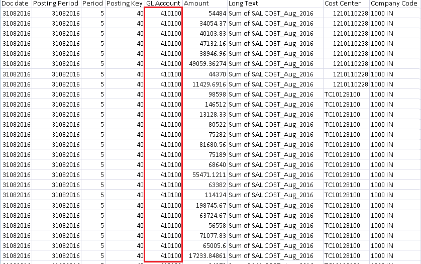

Here are the attached screen shots, currently I am getting the export at leaf level.
leaf level.png (45.7 KiB) Viewed 8297 times
But need the export as below, how to do this ? as all the Dimension in the cube has only one consolidation as total.
Consolidated level.PNG (71.65 KiB) Viewed 8297 times

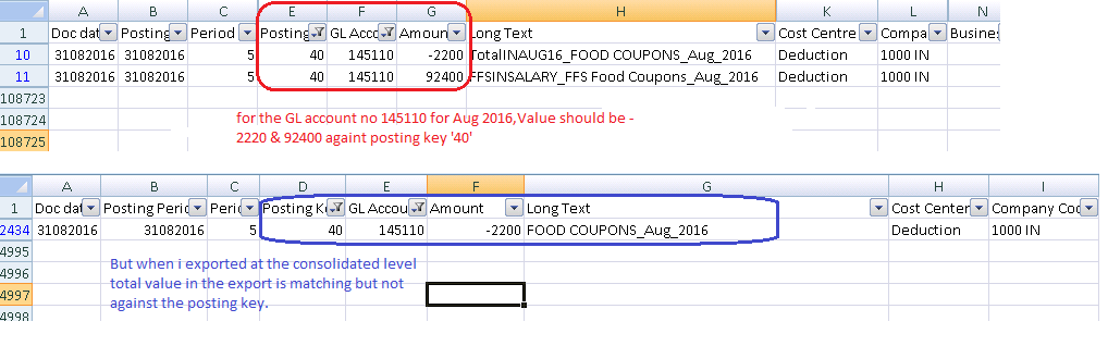

thanks all.I was able to export at the consolidated level but the posting key against the value is matching.
Posting key logic is mentioned below,
IF(V17=1);
IF(Value>0);
vPosting='50';
ELSE;
vPosting='40';
Endif;
Else;
IF(Value>0);
vPosting='40';
ELSE;
vPosting='50';
Endif;
ENDIF;
attached picture of the export.
posting key not matching.png (24.45 KiB) Viewed 8157 times

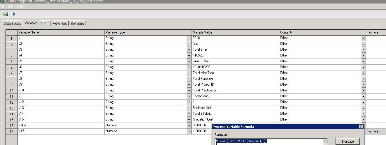

attached the picture of the variables.
defined Variables.png (24.23 KiB) Viewed 8156 times

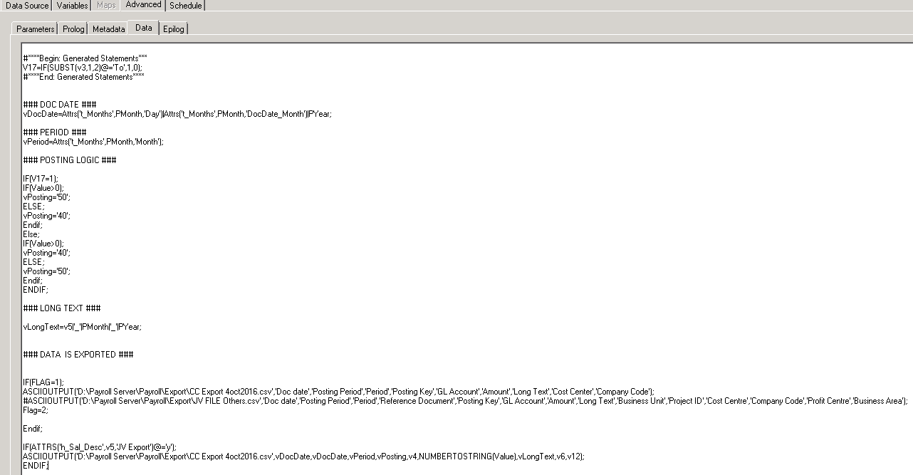

data tab.png (21.55 KiB) Viewed 8155 times
