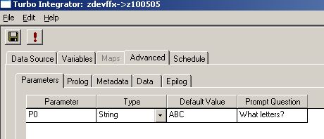

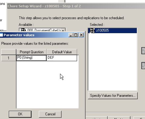

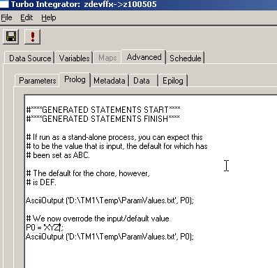

To put this more clearly...
If THIS is the process' Parameters tab, with the default value ABC: And THIS is the code on the Prolog tab: (Edit: That should of course be override, not overrode. Common or garden typo.)
Then when you add the process to a chore you still need to define chore-level default values via the dialog below, which is accessed via the [Specify Values for Parameters...] button. The chore won't let you move to the next step unless you've specified default chore level parameter values for every process which has them: Note two things in particular:
(a) The fact that the default parameter doesn't need to be the same as the one used at process level; and
(b) The absence of a place to specify whether the chore default is a string or numeric value, which is what causes problems if you have a numeric-type default for a string. (Yes, it shows it on the prompt side, but that's just reading from the process. It's not stored with the chore.)
When the process is run as a stand-alone process, then unless I change the default parameter value via the input prompt the output is:
When the process is run as part of a chore, it is:
And thus we see why I say that (a) the chore defaults override the process ones and (b) changing the value in the Prolog overrides both.

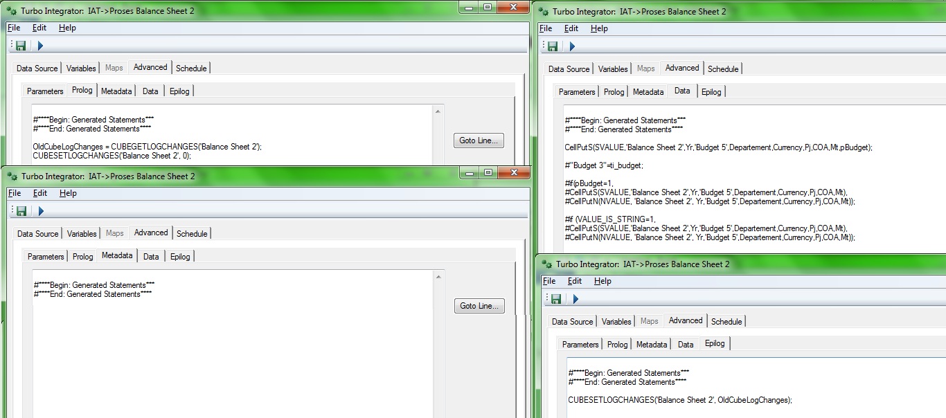

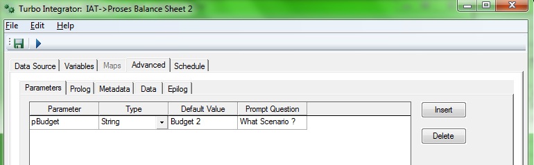

I've make the parameter like in the picture, in Tab Data i've made some formula whis is not work well. Can you help me
- I've make the parameter like in the picture, in Tab Data i've made some formula whis is not work well. Can you help me :|

Re: TI Process with Parameters in a Chore
Datasource that i used is IBM Cognos TM1 View
I want to copy the value in Budget 2 in Dimension Scenario whisi s in the same Cube
i create :
in Tab Parameter the default value of the parameter that i made is Budget 2
then i make the formula like this :
pBudget = 'Budget 4';
The process run success bt in my Cube the value is'nt copy at all
am i make a mistake formula ?
please give me some advice, thank you..
