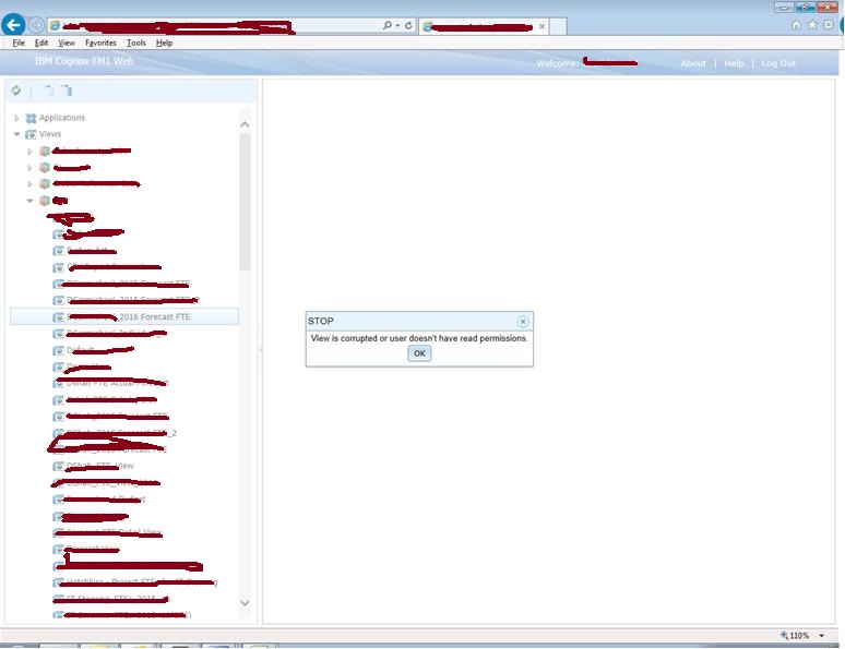

Hi TM1 Experts,
We are using TM1 10.1.1 with Cognos BI workspaces, with Migration of TM1 10.2.2 , Cognos BI workspaces no longer works with TM1 properly. So IBM asked to switch to the Applications published using performance modeler.
Now my Problem with Performance modeler. I copied everything in Data directory and created an application in TM 10.2.2. My application having Cube Security and element security applied, we are using cognos security and groups(IntegratedSecurityMode=5). the application works fine with TM1 web with all security applied.
As soon as I open this application in performance modeler and publish a central application . all views which were working fine previously start giving error like
"view is corrupted or user doesn't have read permission". As a Admin those view works this means view is fine so only issue with security as soon as performance modeler come into the picture .
have anyone faced this kind of situation what is the solution of this?

This issue was because of new group "CAMID("::Everyone")" Added when I am creating an application by Performance modeler. Finally I am able to solve this.
the new group should have READ permission in Cubes security and dimension security by default it has no security assignments you need to define it along with you existing security. Thanks all for the support.
