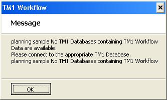

I'm trying to create a new workflow.
when I click "TM1 workflow -> Admin
the following error come up ... any idea?
workflow problem
workflow problem
- workflow.JPG (14.68 KiB) Viewed 4546 times
Re: workflow problem
You either aren't connected to TM1 through your Excel perspectives session when trying to use the TM1 workflow toolbar, or else it looks like workflow has not been installed to your server database directory.
Make sure you are connected as a admin user before using the workflow toolbar. If that sounds kinda obvious and you have already done that then check the database directory; there should be a whole lot of processes, dims and cubes prefixed with "}sm". If there aren't then the required workflow objects haven't been installed to the database directory. You need to do this then restart the server.
To enable workflow, you will need all the workflow objects to be placed in the cube directory in order to start defining all the workflow thingy.
Under default installation, you should see a directory in the Custom folder "TM1 Planning Manager V2" (may change based on release). Copy all the objects in the folder to you cube folder and you should be able to start defining workflow.
