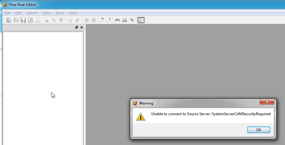

I want to try it but does it work with Cam security? I get the next message when I want to log in.
ScreenHunter_92 Dec. 09 16.24.jpg (32.7 KiB) Viewed 31539 times
Sander
Harvey
Posts: 236
Version: TM1 8.3 onwards
Excel Version: 2003 onwards
Re: Flow TM1 Rule Editor
Post by Harvey »
I haven't been able to test here yet, but I'm pretty sure CAM security is unsupported in this initial release.

Hi Ricky,
Any updates on when you are planning make CAM security compatible ? Unless the editor connects through CAM not many developers can really use it. we love the tool but can't use it.
