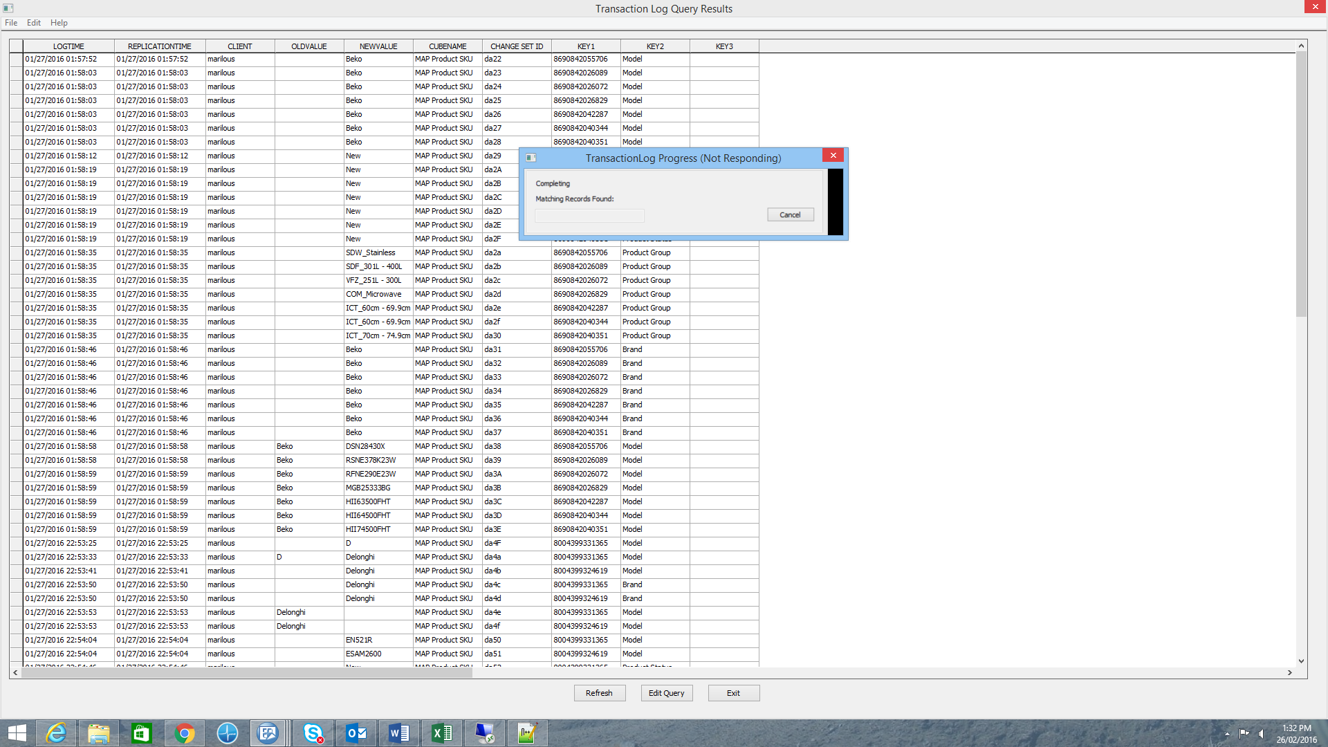

I think i found it?
- tracking changes.png (283.47 KiB) Viewed 8010 times

That's viewing it through the GUI. You're limited in how well you can query that as already mentioned above.nxw wrote:I think i found it?
If you aren't familiar with concepts like your database directory and logging directory (and indeed most of the settings that are in the config file that I pointed you to in the previous post) then you really can't administer a TM1 system effectively. You really should be investing in a proper training course. (Probably one from a consulting firm rather than IBM; you don't need to learn "Just leave everything to Performance Muddler".)
You should have at the very least read the Installation and Configuration Guide cover to cover, with special emphasis on the TM1 Architecture section.
