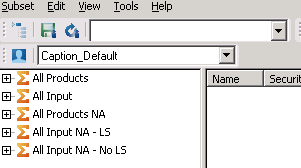

The elementreference 'All Input' on the left hand side is from the productdimension. The problem is that the productdimension is splited in two hierachies without a top consolidated element. This is because of the fact that Europe uses the 'All Input' hierarchy and North America is using the 'All Input NA' hierachy.
This is how the dimension looks like:
I guess it doesnt really matter why it is like this - but it is. I might suggest to the customer that I can consolidate them with a top level, but anyway..
So, to my question is it possible to feed 'FC Calculated volume' twice (!). Is that even possible? Like:
['All Input','FC Volume'] => ['All Products','FC Calculated volume'];
['All Input NA','FC Volume'] => ['All Products NA','FC Calculated volume'];
But before, I will anwer my own theory (partly). I changed to the above for NA and it didnt work. My theory know is because of the fact that FC Volume is fed by Volume and Volume dosent have a value in future years where FC Volume has becasue I use FC Volume to look at previous year and multiply by a "factor"
