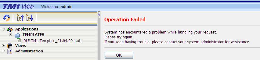

I can browse the cubes and view all data , but i am not able to access the excel sheet put in the application folder of the server. Both the TM1 web and the Server are installed in the same machine and i am trying to access via IE 7.0 also from the same machine.
This is error which i encounter when i try to access the excel sheet even thought it is visible in the left handside pane.
The error screen shot attached.
Any help would be much appreciated.

Re: Error while opening an excel sheet in TM1 web error
sorry forgot the attachment , thanks Alan
- TM1 web error.JPG (34.68 KiB) Viewed 5224 times
From that, I'd be taking a look at all of the things that Lotsaram mentioned, as well as the version of Excel; it should be at least XP, ideally 2003.zameelarif wrote:sorry forgot the attachment , thanks Alan
Also, if that's the only websheet you have on there, try a plain vanilla one; slice only, no action buttons, no formatting and see whether that can be opened. That will at least indicate whether the problem is with websheets generally, or just that specific web sheet.
This probably shouldn't matter (I think) but watch the use of any non-alpha-numeric characters other than an underscore in the name as well. I'm not sure whether those periods in the date component are going to cause a problem.
