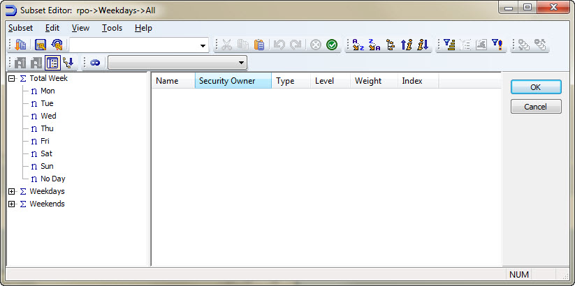

Since my environment isn't "locked down", let me illustrate.
This is a dimension which has no Default subset. Therefore when I open it it launches the equivalent of the All subset, just as your formula should do. Note the absence of duplicates.

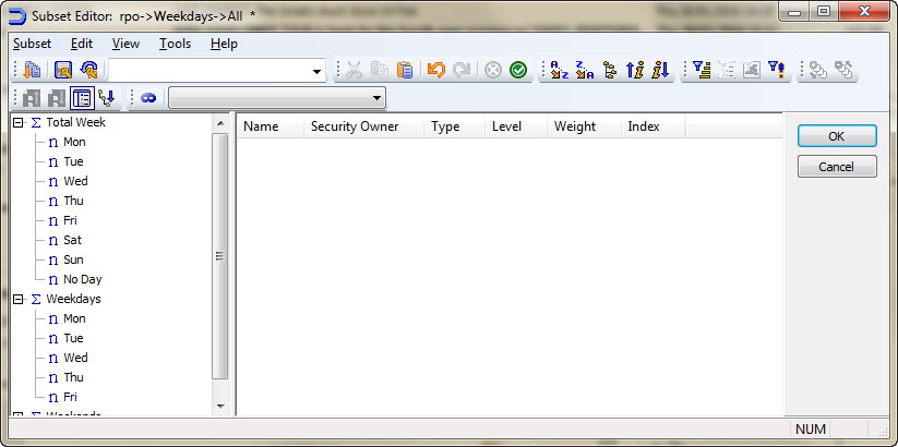

Now I shall expand the Weekdays consolidation.
Lord have mercy, all of the days from Monday to Friday are duplicated!!!!
No, they aren't. They appear under two different consolidations, so when I expand the second consolidation, yes, they will be shown twice. That's because that's what I told Subset Editor to do. The elements are not in the dimension twice, they're not duplicated, they are simply shown in the two places that they appear under.

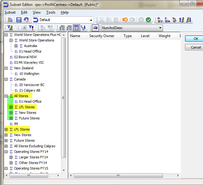

Accordingly what can happen is something like this. (The structure of this dimension has been deliberately done badly to make the point.) Note LFL Stores, which appears below All Stores.
Now I expand All Stores, to reveal its children, one of which is LFL Stores.
Is LFL Stores under All Stores twice? No. The green line line leading down from All Stores to LFL Stores indicates a relationship; the items that are joined to the top element are under that element.
The LFL Stores entry below that does not have a line leading to it. That means that the second occurrence of LFL Stores just part of the list. It is not indicating any relationships with other elements.
The fact that an element appears lower down in the subset list than another element does not imply that the lower one is "under" the upper one. That's only true if there is a descending line.
Conversely, the fact that an element may appear in a subset list multiple times does not imply that that it rolls up to a parent multiple times.
