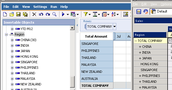

so the C8 package seems to be missing the Total Company (root) of the 'Region' hierarchy/dimension - but it's reading that root MUN as you can see from the 'Total Company' appearing in the analysis studio exploration. TM1 cube viewer on the right.
To get the result I need, I can drag in all the Country level items and Analysis Studio will create the Total for me, but that's no good if I'm building a report and the Region hierarchy changes!
