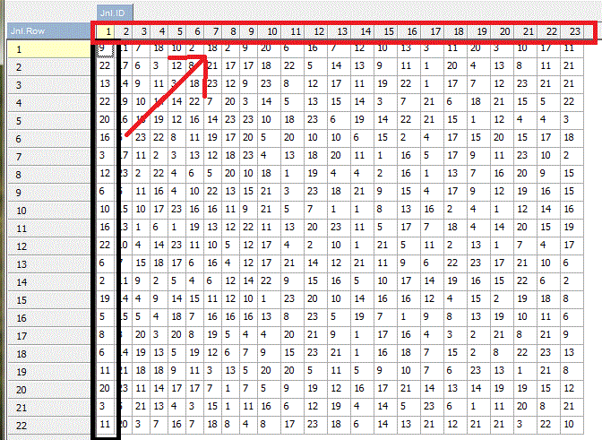

Use string values in a cube to populate subset using MDX.
Playing around with a bit of MDX which touches on a few posts that have come up recently and believe the forum has stated quite clearly that this is not possible.
In the below example is it possible, using MDX, to create a subset of the elements in Jnl.ID based on the string values that have been entered in a cube.

Re: Use string values in a cube to populate subset using MDX.
Cool thanks, "StrToMember" is what I was missing I think. Cheers
