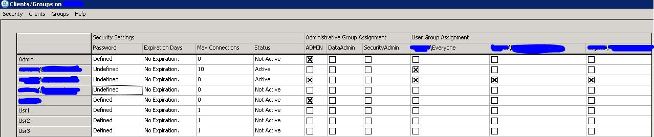

Hi Gurus,
I have set up a new instance 10.2.2 FP2 of TM1 and for some reason, security does not flow to the user.
I have imported the groups and user from the name space and User is in the AD group. Used IntegratedSecurityMode=5. Ideally, I want this implemented in contributor.
When the user logs in through perspectives, I see him checked under every one, but access to the group is not. Any idea where I could have gone wrong?
Paul.

TM1 security not flowing to the users
- Security Issue.JPG (77.59 KiB) Viewed 2751 times

Re: TM1 security not flowing to the users
Are you using CAM? If you are and they are not set to be in Everyone there, then when they login it will remove them from everyone as the security syncs (at the group level) whenever a user logs on,

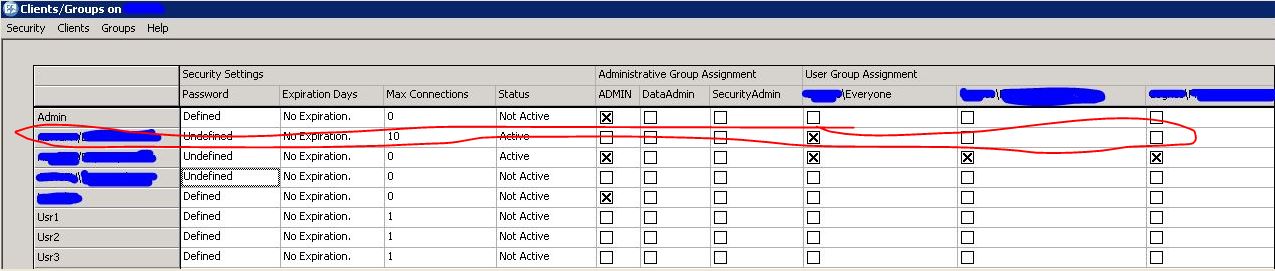

LutherPaul
- Posts: 80
- Joined: Tue Jun 04, 2013 3:35 pm
Thanks Jim.
We are using CAM security. The user in question (marked in red) is in Everyone group and I have added a new picture. It's understood, even if I uncheck user from everyone, it gets turned on when user logs on which is right. But the groups next to it are not getting checked. what is missing in getting the groups checked?
Our environment: Version 10.2.2 FP2 on Windows 2008 R2 server.
- Security Issue.JPG (83.31 KiB) Viewed 2735 times
Is the user in the user in the other groups in CAM as well?
