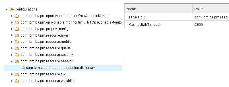

Hi Brianl,
The MaxInactivityTimeout in my configuration is 3600, which means the CAFE can be active for 1hour after login, but it seems the session is logoff after 30mins. Is there any other configuration to modify? Thanks.
wendy
wendy
- session.PNG (11.48 KiB) Viewed 4463 times
