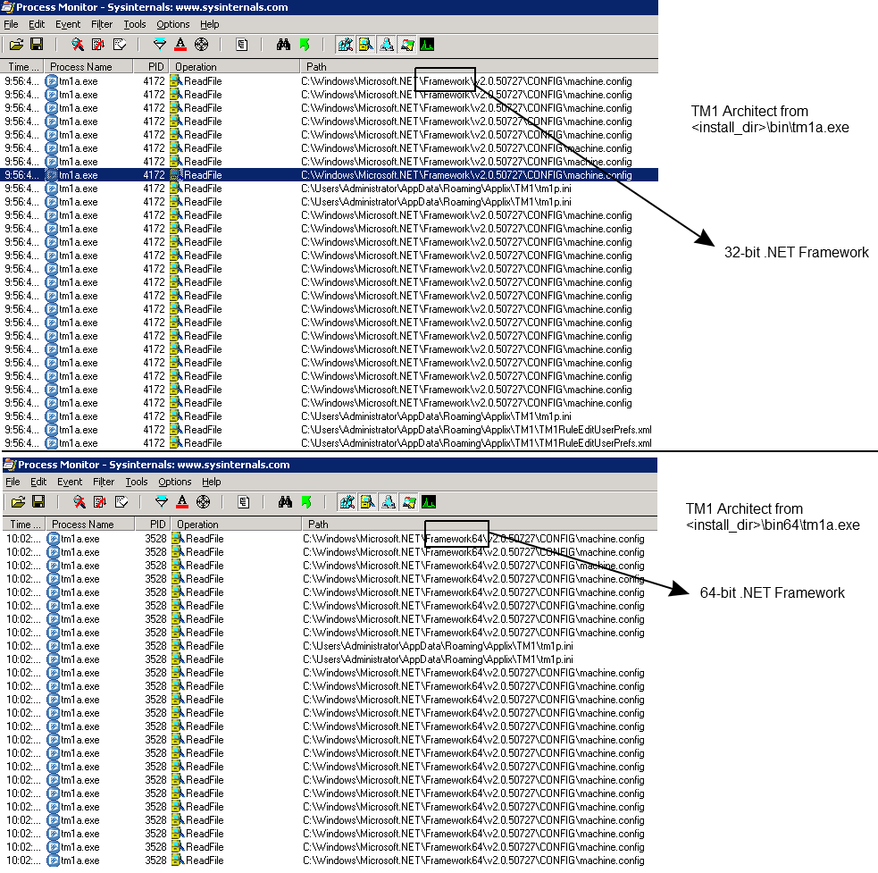

I did the comparison in Process Monitor (freeware program). I started monitoring in Process Monitor just before double click on rule to launch Advanced Rule Editor.
1. Started TM1 Architect 32-bit witch runs 32-bit .NET Framework.
2. (Closed 32-bit Architect). Started 64-bit Architect with runs 64-bit .NET Framework.
See attachment for details.
Looks like the problem with 64-bit Architect should be investigated in updating 64-bit .NET Framework, because 64-bit Architect still calls .NET Framework (64-bit in this case)... But I decided to stop investigating in this stage, because 32-bit Architect is working without a problem and see no need of using 64-bit Architect at this point. Because IBM declared Advanced Rules Editor as "not supported", there may be some problems with 64-bit Architect with 64-bit .NET Framework that is not easy to resolve.
- tm1_architect_with_dot_net_framework.png (125.92 KiB) Viewed 13802 times
