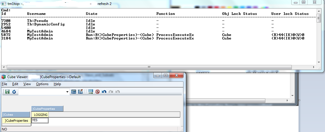

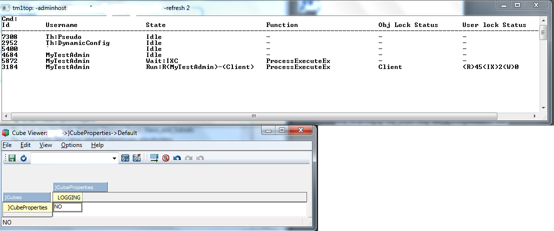

Look at my testing scenario:
I have a TI Process with your code in Prolog and Epilog, and I login twice and run the TI.
1. Scenario_1: Logging for }CubeProperties cube if OFF. The second instance of the process in on wait
Logging for }CubeProperties is OFF
2. Scenario_2: Logging for }CubeProperties is ON. Both instances run in parallel
3. Scenario_3: Turned Off again Logging for }CubeProperties
Logging for }CubeProperties is turned off again
We downloaded FP3 and installed in a POC environment and I will try there, but this has been like this since 9.5.2
