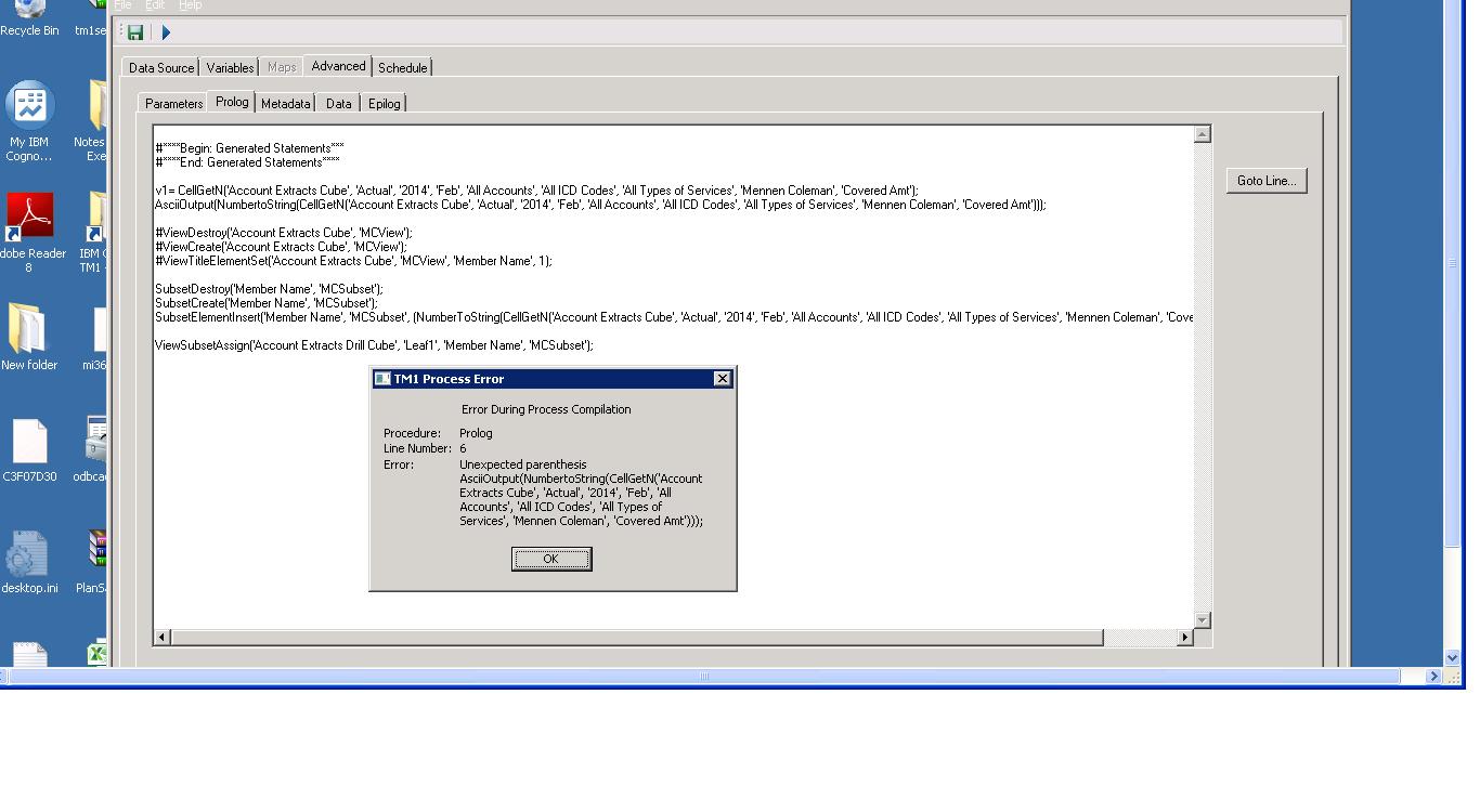

Wim, I had tried Asciioutput before as well and faced issues -
- When I try Asciioutput as suggested by you, it gives me error saying 'Unexpected Parenthesis'.
Unexpected Parenthesis Error
Unexpected Parenthesis.JPG (116.57 KiB) Viewed 11638 times

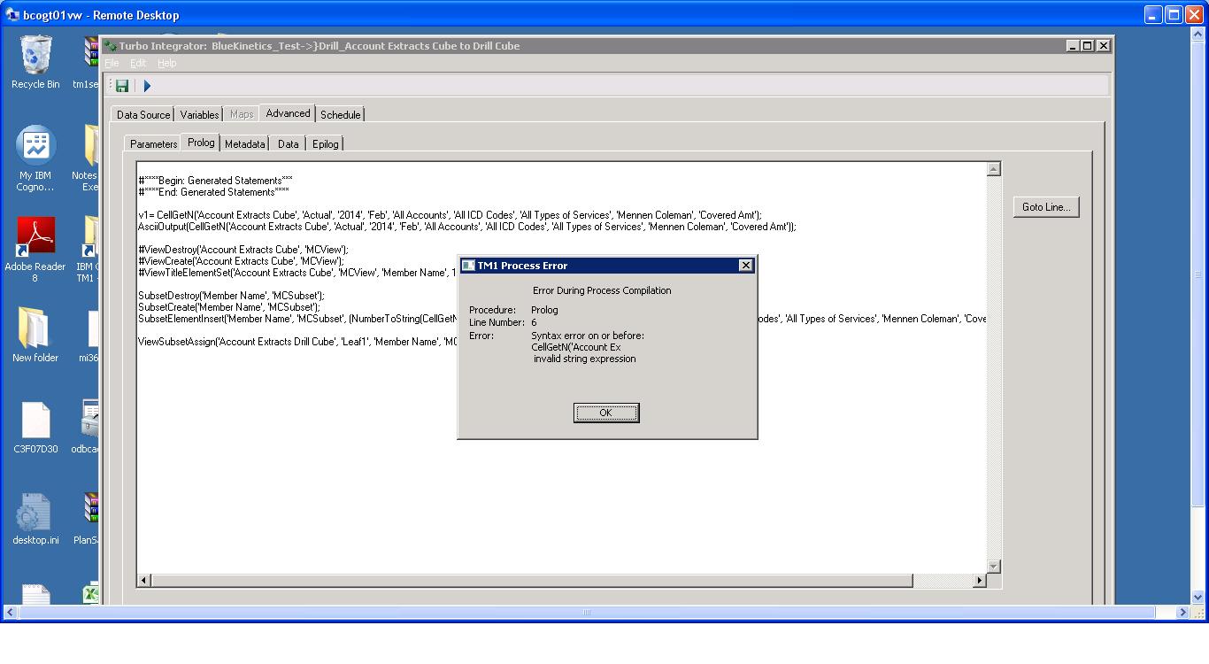

- If I remove NumberToString function, it throws error - 'Invalid String Expression'

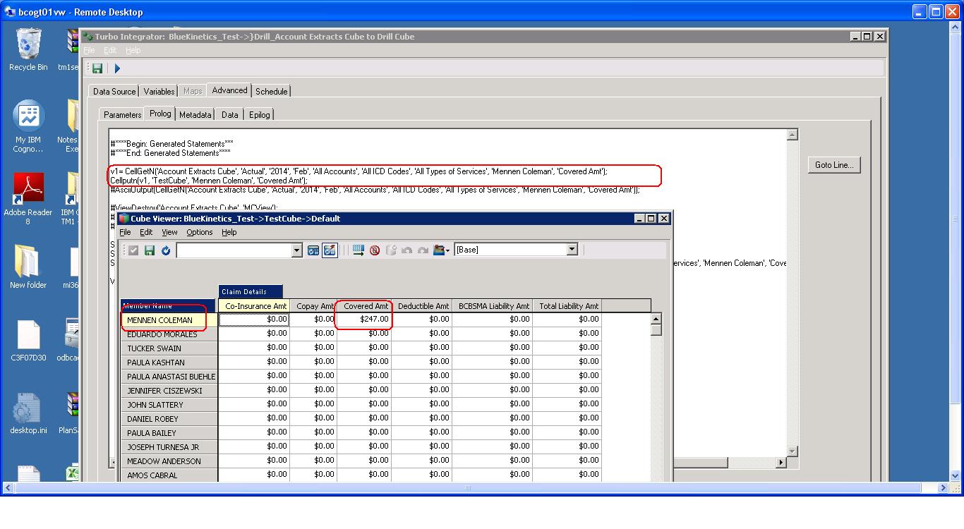

Hence, I tried adding this value to a test cube using CellPutN and the actual Covered Amount for the member is added correctly as shown below.

Wim Gielis wrote:What do you get and does it exist in the dimension 'Member Name'?
The dimension 'Member Name' just consists of member's name.
Wim Gielis wrote:Am I right when I say that you look up an amount into a dimension containing names? Seems strange.
Against each member name, the dimension called 'Dollar Amount' shows the consolidated claims dollar amount. This is the origination cube. In the drill cube, the break-up of the claims are displayed.

I've not enough time right now to go deep inside your issue but I can see that you have to Change the AsciiOutput-Command. The first Argument has to be the filename in what the Output should be written.
Re: Drill through customization
Willi wrote:I've not enough time right now to go deep inside your issue but I can see that you have to Change the AsciiOutput-Command. The first Argument has to be the filename in what the Output should be written.
Yes sorry, I forgot the first argument of the AsciiOutput function: a filename and/or an extension and/or a directory.
Without extension, .cma will be assumed.
Without directory, TM1's data directory will be assumed.

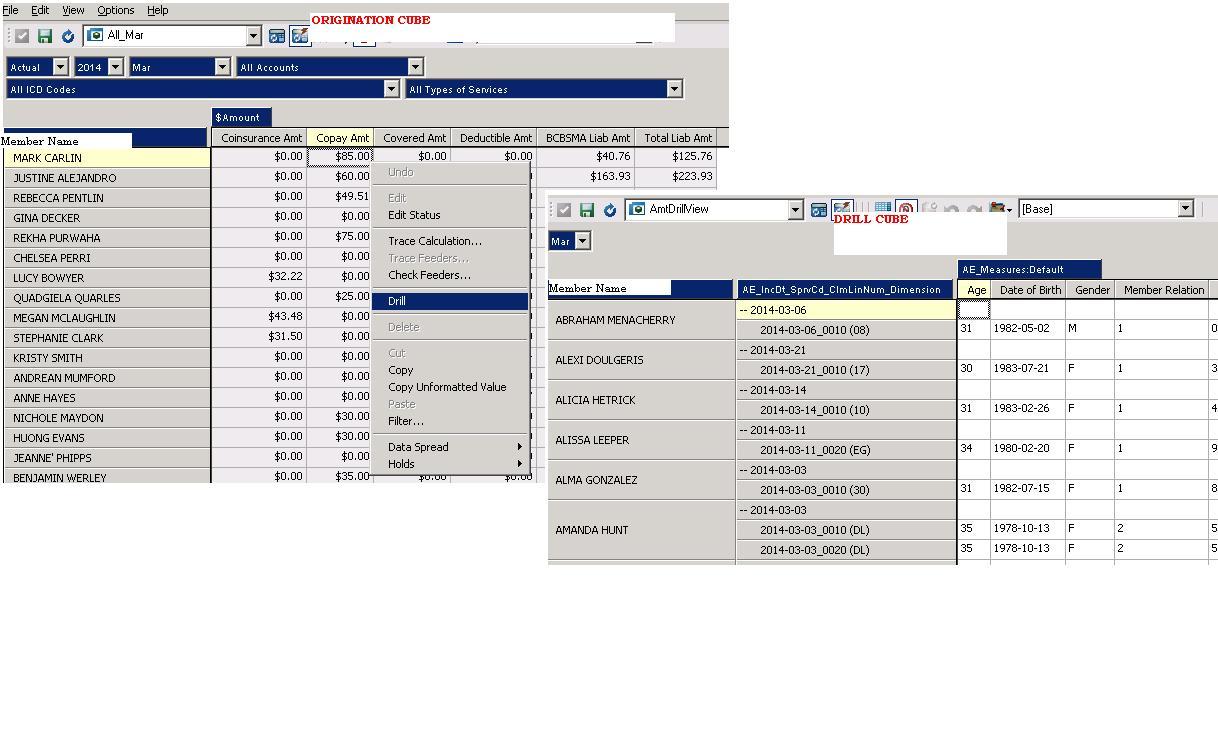

Decalnr, screenshot showing drill from origination cube to drill cube is as shown below -
Org cube to drill cube
Org Cube to Drill Cube.JPG (130.34 KiB) Viewed 11597 times
Tomok, i get my mistake. I was trying to pass an element from one dimension ($ amt) to another (member name); hence the element was not being added. As per your suggestion, I tried to pass the parameter value that represents the member name into the SubsetInsert function. So now for any member selected from the origination cube, the drill cube shows only the member that was passed through the subsetinsert function. How do I achieve the functionality of dynamically passing the selected member name to the drill cube so that only equivalent member's details are displayed?
