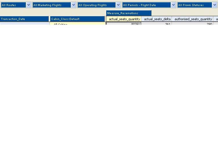

I need urgent help from you guys. I am facing same kind of issue. Actually, i am writing the rules function to roll up measure values to higher level. my requirement is the last transaction record/values to rolled up to month, qtr,year and all year. for referrence, I have attached the screenshots.
1. the last transaction date measure value rolled up to month consolidation
2. last month to QTR
3. last QTR to year
4. last year to All year like that.
for that I have written rules and achived but,whenever the latest record comes, I need to modify the rules function. because i have hardcoded the date value.
I need to remove the hardcoding date value and it should find the elementg index and automatically update/roll up the measure.
This below function is working only when the month has completed dates. This function always find the last day of the month.
['actual_seats_quantity','Transaction_Date':{'2014-QTR3'}] =N: STET; C:DB('Reservation Cube', !Route,!marketing_flight_number, !operating_flight_number,!Cabin_Class,
!Flight_Date, !Flown_Status, ELCOMP('Transaction_Date', '2014-QTR3', ELCOMPN('Transaction_Date', '2014-QTR3')), 'actual_seats_quantity');
For incompleted month or current month, I need to write the below rules.
['Transaction_Date':{'2014-QTR3'},'Cabin_Class':{'All Cabins'}, 'Measure_Reservations':{'actual_seats_quantity'}]=C:['Transaction_Date':'SEP-2014'];
['Transaction_Date':{'2014-QTR3'},'Cabin_Class':{'J - Business'}, 'Measure_Reservations':{'actual_seats_quantity'}]=C:['Transaction_Date':'SEP-2014'];
['Transaction_Date':{'2014-QTR3'},'Cabin_Class':{'W - Premium Economy'}, 'Measure_Reservations':{'actual_seats_quantity'}]=C:['Transaction_Date':'SEP-2014'];
['Transaction_Date':{'2014'},'Cabin_Class':{'All Cabins'}, 'Measure_Reservations':{'actual_seats_quantity'}]=C:['Transaction_Date':'2014-QTR3'];
And etc…
Ara
3. last QTR to year
And etc…
Ara
- cube sample
- cube picture.JPG (40.76 KiB) Viewed 9792 times
- dimensions
- cube dimensions.JPG (23.69 KiB) Viewed 9792 times
