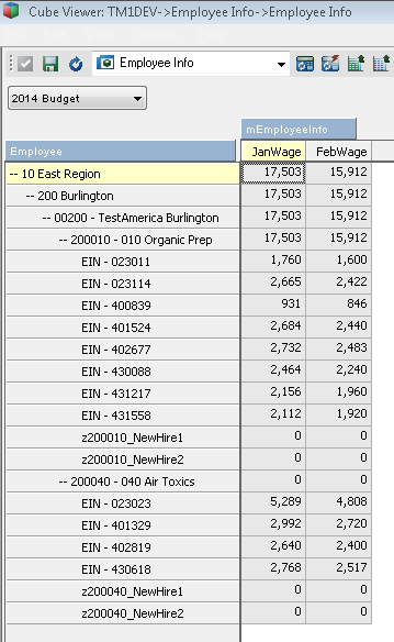

I use TM1 10.1. I am testing to write a rule to copy first parents of n level elements' Monthly Wages to a summary cube without the need of creating an intermediate calculation cube. It is from our staff planning's employee Info cube.
Employee Info Capture.PNG (22.61 KiB) Viewed 3114 times

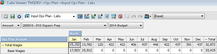

to our Ops Plan Cube
Op Plan Capture.PNG (16.91 KiB) Viewed 3114 times
If I hardcoded the first 0 level element (EIN - 023011) of "200010-010 Organic Prep" dept in the rule, below rule works
['Base Wages', 'Jan']=N:DB('Employee Info', ELPAR('Employee', 'EIN - 023011', 1), 'Budget','JanWage');

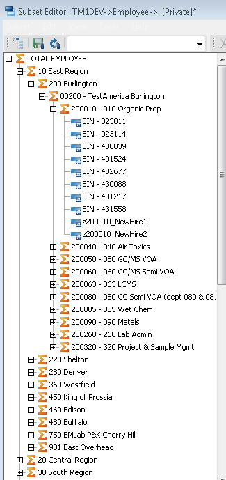

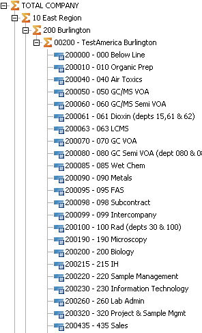

Employee Dimension was built one level under "COMPANY" dim's hierarchy tree (BU is zero level of Company Dim), but for "Employee" dim, Employee Identification Number (EIN -XXXX) is n level element. My Ops Plan Summary cube removes "Employee" Dim, Add " Company" Dim, sum all employees' wages to each BU which is n level of company dim. For instance,
Total Employee
10 East Region (Company Dim)
200 Burlington (Company Dim)
200010(BU, n level Company Dim)
EIN- 023011 (Employee #1, Employee ID)
EIN-023114 (Employee #2, Employee ID)
200040 (Burlington Air Toxic Dept)
280 Denver
280010(Business Unit is Lab Location + Dept, e.g Burlington Organic Pre Dept)
EIN- XXXX (Employee #1)
EIN-XXXX (Employee #2)
20040 (Burlington Air Toxic Dept)
Employee Dim Capture.PNG (22.85 KiB) Viewed 3103 times
Company Dim Capture.PNG (13.73 KiB) Viewed 3103 times

Yes so you can reference the consolidated element in your source dimension since it has the same name as the nodal element in your destination dim.
['Base Wages', 'Jan']=N:DB('Employee Info', !Company, 'Budget','JanWage');
