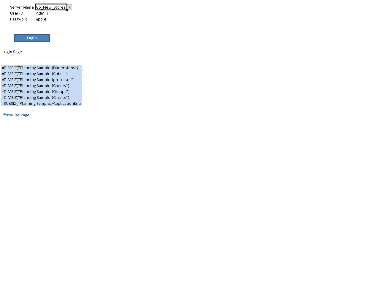

Is there any option to connect the a server from perspective, if I provide the server details(server name, user id and password ) in the columns of excel. As shown in the attached screenshot by taking those column values as inputs can we connect to that perticular server?

By using N_Connect function I am able to connect to server through excel
One more query, I want to pass the server name from login page to all formulas used remaining pages
For example, if I connected to Go_New_Stores server in login page, all formulas should use Go_New_Stores. At present it is using Planning sample, but preferably when I connect to Go_New_Stores then formulas also take Go_New_Stores instead of Planning sample

I have Given Cell Reference(Login page Server Name Cell ) But It is Not working

I suggest that you post the EXACT FORMULA that you're using rather than the above abstraction of it. And when it comes to "not working"?satya.bhamidipati wrote:I have Given Cell Reference(Login page Server Name Cell ) But It is Not working
