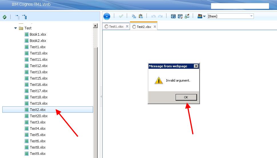

1. We have updated Cognos Express 9.5 to 10.2.1
2. IF open in TM1WEB one Excel form with buttons (button run TI) and then open second Excel form with buttons (button run TI) - TM1WEB generate Error message
"Message from webpage Invalid Argument"
After update Cognos Express 9.5 to 10.2.1 do not work excel
- error.jpg (48.14 KiB) Viewed 6392 times

I also faced the same issue . IF I open TM1WEB one Excel form and then open second Excel form with action button, TM1WEB generate Error message
My Excel sheet doesnot have any formula. Also if i go with the below suggested point to change the compatibilty mode of IE8, that also doesnot help me and still giving the same error message.

So the Action button in the first websheet shall navigate / jump to the second websheet ?
If so, what happens when you click the OK button of the error message ?
Does the error message pop up again ?
And after you click the OK button of the second error message you navigate / jump from the first to the second websheet ?
And you are using the MSIE 8 web browser ?
If so, you have been hit by the open software defect logged as APAR PI13089:
https://www-304.ibm.com/support/entdocv ... wg1PI13089
PI13089: USING TM1 WEB 10.2.0.1.2 AN ACTION BUTTON TO NAVIGATE TO ANOTHER WEBSHEET RETURNS ERROR MESSAGE "INVALID ARGUMENT"

Using TM1 Web 10.2.0.1.2 an Action Button to navigate to another websheet returns error message "Invalid argument"
A websheet has an Action Button to navigate to another websheet.
When using TM1 Web 10.2.0.1.2 on MSIE 8 web browser, in an english environment a click on the Action Button returns the english error message:
Invalid argument
twice before to navigate to the other websheet succeeds.
In a german environment the german error message:
Meldung von Webseite
Ungültiges Argument
is returned twice.
When using TM1 Web 10.2.0.1.2 on the Firefox ESR 17 web browser everything works, a click on the Action Button to navigate to another websheet does not return an error message.

Thanks for the reply,
yes, I am using MSIE8 web Browser. Also, The same template works fine in Chrome. So it seems that issue is with IE8 only.
Thank you for the Defect Log ID
