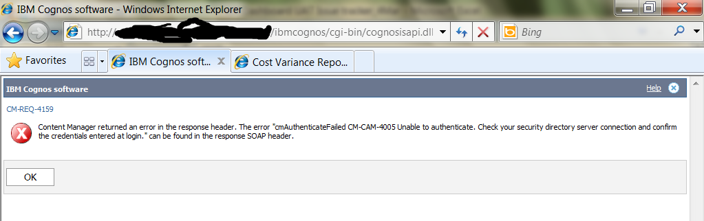

Then users started to encounter long waiting time during login, specifically in TM1 Web. We use CAM authentication by the way, IntegratedSecurityMode=5. At first, users just waited until they got logged-in successfully, until recently when it became so frequent and the waiting time took longer. Then came the point when TM1 web prompted an error (see attached) to users.
So we investigated and found out that there have been connection disruptions between our Cognos server (Content Manager) and the Content Store server. We verified that the credentials used to connect to the Content Store still works. The password has no expiry.

TM1 web error message
Content Manager error.png (101.93 KiB) Viewed 2822 times
