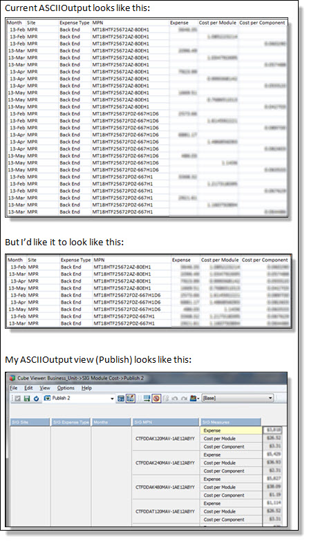

I was wondering if you knew how to accomplish this. I am exporting into a .csv a multidimensional cube. I want my measures to be across the top - in this case, they are Expense, Cost Per Module, and Cost Per Component. I've accomplished that - no problem. :) However, it's doing it in a line per measure versus just combining (see my example). This typically wouldn't be a big issue, but this cube is quite large and that will 'eat up' a lot of space needlessly.
Am I almost there? :?

Thanks a lot for any suggestions to get it like I am showing below in the middle screenshot!
ASCIIOutput Example.jpg (123.39 KiB) Viewed 10982 times

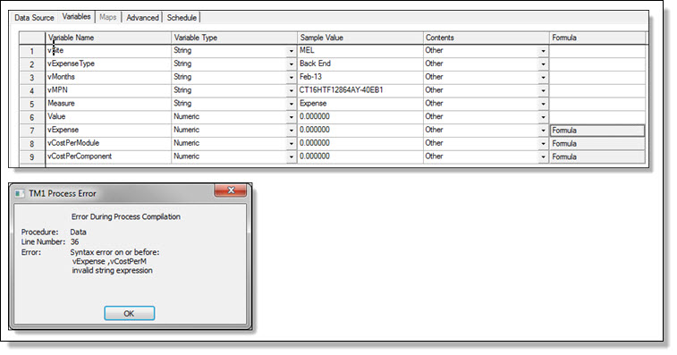

:oops: I'm at a bit of a loss. I've been looking on the forum, on the internet, etc. and haven't been able to figure out why I am getting an error. I asked a coworker who recently went through some actual training and she said they didnt' cover CellGetN and CellGetS in class :(
I am using the CellGetN as recommended, and when I "Evaluate" in the Formula, I do not get an error - it is accepted. However, when I try to save the Process, I get an error. All of the elements in my Measures dimension (which is last in the cube) are #, not AB (String).
I've tried changing my Variable types and that hasn't been successful either :(
Any ideas? Appreciate the help!
Variables Tab and Error Upon Save.jpg (64.21 KiB) Viewed 10908 times
Re: ASCIIOutput - Measures across top
Asciioutputs need all items to be string.
Try converting the numeric values to strings using NumberToString() and that should do the trick.
