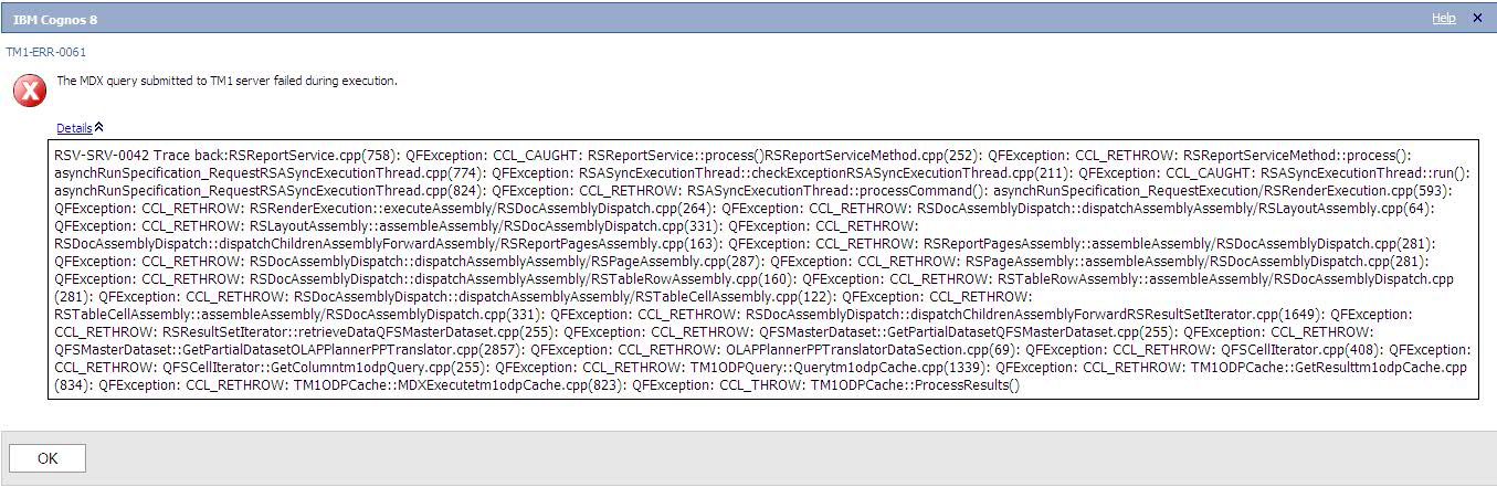

Running the Cognos BI report in Report Studio we faced the below error as
TM1-ERR-0061
"The MDX Query submitted to TM1 server failed during Execution"

Hi Macsir,
The below attached is the MDX query error we got while running the report in Report Studio
TM1 MDX query.jpg (169.86 KiB) Viewed 5355 times
