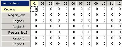

Sometimes it is necessary to show for users pseudo hierarchies which are looking like a hierarchy but they are not
For example like this
(see theme about it here
http://www.tm1forum.com/viewtopic.php?f=3&t=8833 )
But it seems this idea doesn't work properly

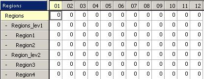

The only way which comes to my mind is create alias which look like
And it looks in view like
But first variant looks better because in the second one I have to add symbol '-' in start of element in alias - unfortunattely I can't start from spaces ' ' in names
So may be somebody could give me idea how to show pseudo hierarchies which would look like the first case.
Re: Ways of create pseudo hierarchies
You can use the ASCII ALT-255 character as a indenting prefix in an alias. This is a space character but is not ignored by TM1 as are regular spaces.
Post by EP_explorer »
lotsaram wrote:You can use the ASCII ALT-255 character as a indenting prefix in an alias. This is a space character but is not ignored by TM1 as are regular spaces.
When I tried to input alt+255 in Attributes Editor it saves only without first empty places - think it is a space anyway.
But helps
  str1=Char(160) |  '  Regions_lev1';
  AttrPutS(str1, 'Regions', 'Regions_lev1', 'Reg_name');
