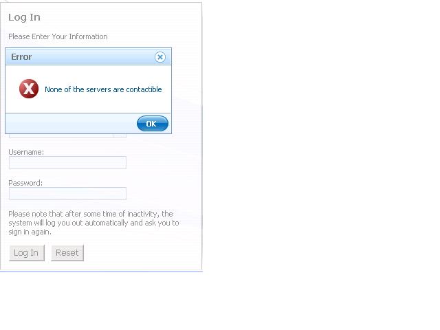

Please find attached error screen shot, I am getting this error from TM1 Operations Console "None of the Servers are compatible". I have configured
OPSConfig.xml file:
<?xml version="1.0" encoding="UTF-8"?>
<ops>
<adminhost name="prodtm1">
<server name = "TM1Server">
<group>DataAdmin</group>
</server>
</adminhost>
</ops>
Operation Console Error.JPG (19.28 KiB) Viewed 1763 times

Did you add the keys to the java keystore? You will receive this error if you haven't added them.
