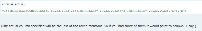

When you create a new active form by default you get a formula put in column A, that formula being (let's use the case of a form with two row dimensions) something like this:
=IF(TM1RPTELISCONSOLIDATED($C$23,$C23),IF(TM1RPTELLEV($C$23,$C23)<=3,TM1RPTELLEV($C$23,$C23),"D"),"N")
(The actual column specified will be the last of the row dimensions. So if you had three of them it would point to column D, say.)
That formula is a little hard to get your head around if you aren't familiar with the TM1RPT functions, and doing so is left as an exercise for the reader if you want to. You'll find the relevant documentation of each function in the Reference Guide. (Though the gist of it is that it works out whether it's a consolidation or an N level. If it'[s a consolidation, how many levels away from the top level consolidation is it? (0, 1, 2, 3 or more (D).) There are a few important things to note about it, though:

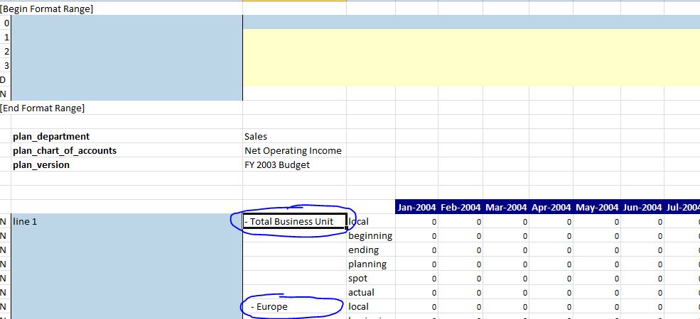

If Yes, Is there a way I could highlight the consolidated elements shown in the below screenshot (Just these elements and not the entire column)
Suharsh....

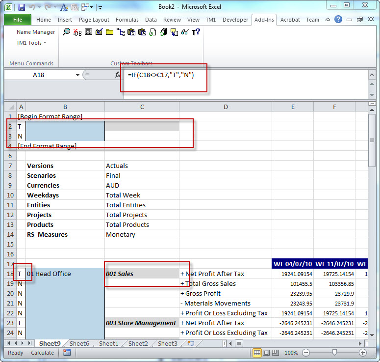

Suharsh wrote:If Yes, Is there a way I could highlight the consolidated elements shown in the below screenshot (Just these elements and not the entire column)
The attachment Capture.JPG is no longer available
In the example that you're showing they're all N elements at the innermost level so honestly, I wouldn't even bother using TM1RPT formulas to define the formatting code. Instead I'd use the standard Excel formula (let's say that the active form starts on row 18)
=IF(C18<>C17,"T","N")
(T being for "Top" in this case, though the code that you choose isn't important.)
In the formatting block you could get rid of all but two of the rows. One will be N for standard rows, and one will be T which is formatted in exactly the same way as the N one except for the highlighting of column C.
That would look a little somethin' like this:
The same basic principle applies if you had a combination of consolidations and N elements; you could use the default formatting formulas, just modified with an extra And() function to check whether there's a change in the column value as well. For each "standard" format (the "N" format in my example, 0 to 3, N and D in standard formatting codes) add an extra one which applies if the value in that column changes from the value above (the "T" one in my example, make up your own if you're using the standard formats and codes).
