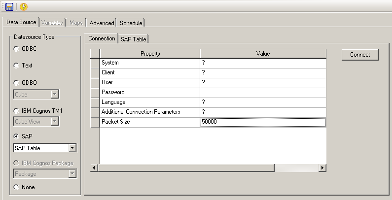

Hi Everyone,
Does anyone know the 1st steps to establish connection to SAP (ECC 6.0) using TI ?
There seem to be some posts relating to people who are already running queries but nothing for people who have only used text file, odbc [system dsn] or none.
And i've had a look at the FAQ as well (Thanks Alan [from another post]).
Any ideas or comment(s) would be good

yyi wrote:Does anyone know the 1st steps to establish connection to SAP (ECC 6.0) using TI ?
There are two SAP BW Connectors for TM1:
1)
The old TM1 SAP BW RFC Connector aka the Syskoplan Connector. The Syskoplan Connector cannot access SAP ECC.
IBM Cognos stopped to offer and sell the Syskoplan Connector in August 2010:
http://www-01.ibm.com/common/ssi/cgi-bi ... ppname=USN
Software withdrawal: IBM Cognos TM1 Connector for SAP
http://www.ibm.com/common/ssi/rep_ca/0/ ... 10-190.PDF
According to your screenshot you tried to use the Syskoplan Connector to access SAP ECC.
2)
The new TM1 Package Connector.
Using Virtual View Manager (VVM) it is possible for the TM1 Package Connector to access SAP ECC, see for instance the thread
http://www.tm1forum.com/viewtopic.php?p=35442
How to connect cognos TM1 to Cognos Virtual view manager?
in the TM1 Forum.
On how to use the TM1 Package Connector see the Chapter 8: "Access SAP Data Sources Using IBM Cognos TM1 Package Connector", page 133 to 165, in the Cognos Proven Practice: "IBM Cookbook for IBM Cognos 8.4 for use with SAP NetWeaver Business Warehouse" ->
