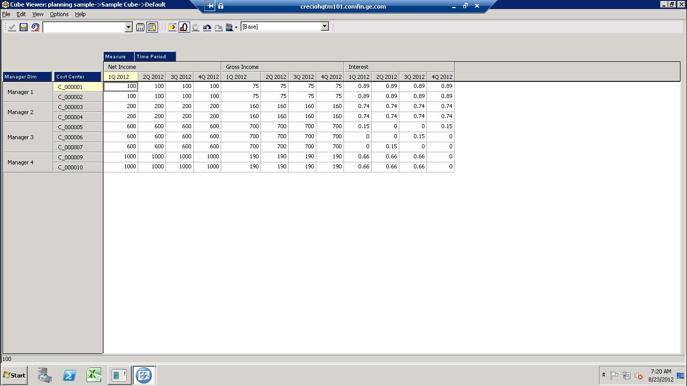

Thanks for the reply. I am sorry for not properly depicting my requirement, I was in little rush last night. Actually the sample scenario is as metioned :
So the Manager 1 is the guy who owned the two cost centers named C_000001 and C_000002 and similarly others as well. Now what we want is that Manager 2 should not be able to see the data of Mnager 1, in spite of the fact that they belong to same user group. Suppose they are tagged with user group "Group 1_ Canada".
Is it possible that we can assign different security capabilities to the clients of same group in TM1?
No doubt Groups is the basis of TM1 and all client inherits the security rights for their groups only. But still is there any possibilites to assign different security rights to different user of same group?
Thanks in advance for your precious time and response.
Best Regards,
Priyank.

Yes of course, provided that the clients are also members of OTHER GROUPS where membership does not overlap. Take your example above: all clients would be members of the "Sample Cube" group which would give write access to Sample Cube but only Manager 1 would be a member of the "M1" group which would have write access to "Manager 1" in the Manager dim and no access to any other elements therefore they would only see Manager 1 and data for cost centers 1 & 2. In the design of the cube you have you could probably only secure the manager dim but I would argue that is would be better to secure cost center as well.
